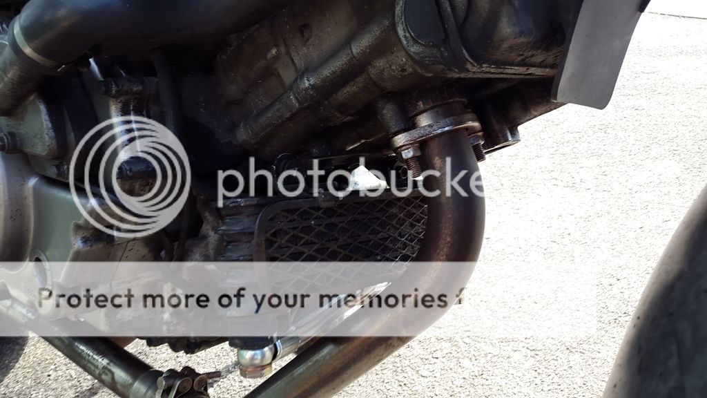

gt900uk 17-04-15 01:07 PM
Re: Snapped Studs
All fixed :)http://i366.photobucket.com/albums/o...417_135831.jpg
TamSV 17-04-15 03:49 PM
Re: Snapped Studs
Well done. :salut:
How did you deal with it in the end?
gt900uk 17-04-15 04:10 PM
Re: Snapped Studs
Drilled them out and re tapped. Fitted stainless studs and bolts with anti seize compound, so hopefully no issues in the future!
