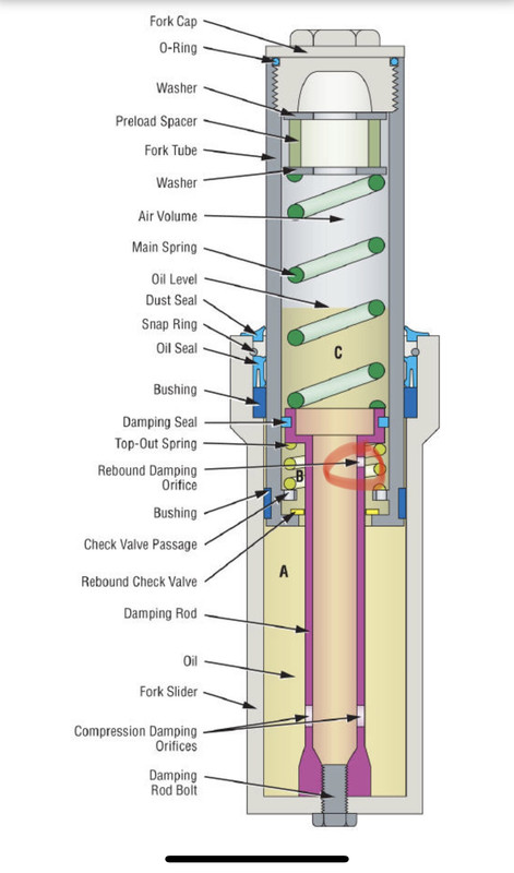

the SV forks on both gens check valves leak like a bucket with holes in it. this is why you weld the rebound holes, doing this lets you use a lighter weight of fork oil. if you dont weld the rebound holes you have to use too heavy an oil which will slow the reaction time of the stanchion down so you end up with a harsh ride as the rebound/compression cant move quick enough.

yes you could drill and tap the rebound holes and put bolts in but they would need to be inserted from the inside of the damper tube with threadlock. the excess bolt coming out of the front would need to be dressed flush to the outside of the tube.
if all the above is done correctly damper rod forks can be about 90% as good as full cartridge and plenty good enough for road use.

Would this be the hole you mean on this diagram that I have marked in red ?
https://i.postimg.cc/B6MwLLT3/IMG-2722.jpg
I will try finding someone to do the weld for me, like you say, I can use the postal service.

Thanks. I’m going to get a braze torch and some copper rods and give that a go. I’m used to doing solder work so hopefully I won’t F up my forks :rolleyes:
