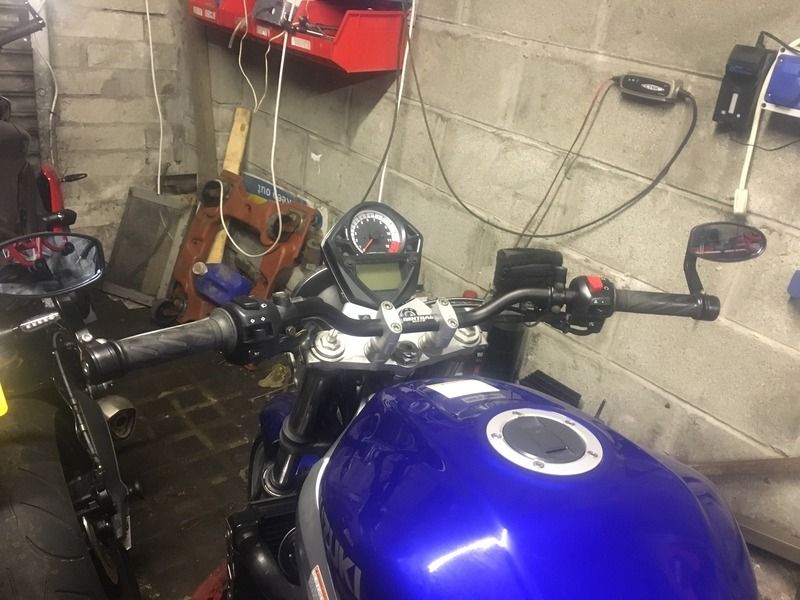

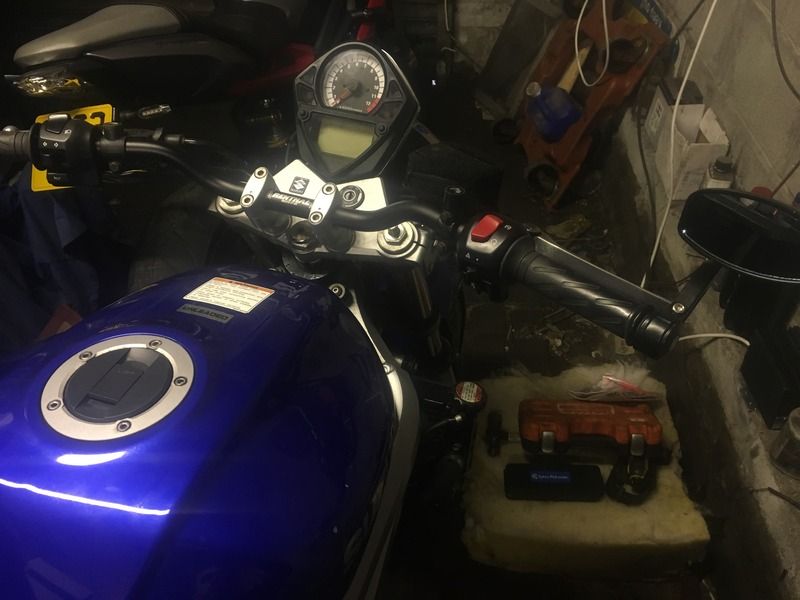

Next I removed my bars and fitted a set of Black Renthal bars and cheap bar end mirrors.
http://i4.photobucket.com/albums/y14...pspeyeqimu.jpg
http://i4.photobucket.com/albums/y14...psdqhbt9i5.jpg

Where did you get the mirrors from?
Exuptoy 31-03-17 08:28 PM
Re: New project in the garage.
http://www.ebay.co.uk/itm/3813747681...%3AMEBIDX%3AIT
They seem alright for £9.
Only issue was I had to grind the corners off the nut and run the rubber insert along the edge of a grinder wheel as the Renthal bars are a LOT thicker walled than standard.

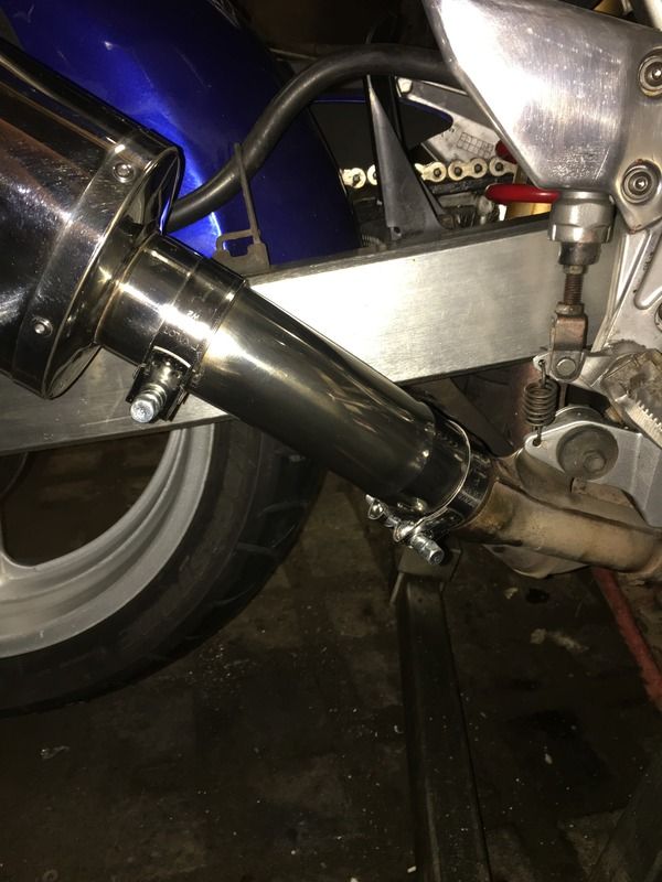

Last night after work I popped up the man cave for a motorcycle maintenance fix and fitted the new 7x5.5 plate, LED India relay and 2 x new stainless exhaust clamps.
Why would you not replace 2 x rusty clamps for £5.
After polishing the end can and link pipe it made sense to change them. Only issue is now I may have to brighten up the headers with some Harpic!
http://i4.photobucket.com/albums/y14...ps35wwrh2u.jpg

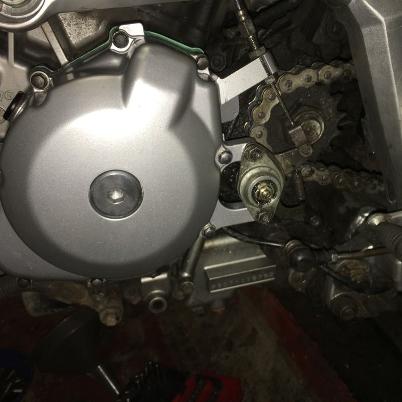

Exuptoy 03-04-17 09:08 PM
Got the gen cover back on tonight and partially cleaned up the clutch actuator and surrounding area.
http://i4.photobucket.com/albums/y14...ps7qu7fuyz.jpg
Blapper 04-04-17 06:28 AM
Best way to clean that clutch actuator is strip, clean & re-grease. I used Molygrease.
You can give the rest of the area a thorough clean while it is off.
Exuptoy 04-04-17 06:43 AM
Cheers Blapper. I did strip and clean it and just put regular grease in there although 2 ball bearings fell out. They went back in just fine though. Need to set up and adjust the clutch properly today.
Geodude 04-04-17 06:55 AM
Just checking but im sure that the spring return arm goes in front of the worm drive not behind?
Geodude 04-04-17 07:11 AM
By that i mean the lower bit that holds the return spring
Exuptoy 04-04-17 07:18 AM
It's how it came off.
Anyone have a pic of the correct set up?
