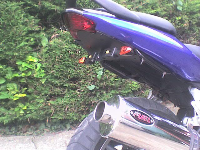

ok so today i started work on making my own tail tidy and under tray and this is how far i am at the moment.
http://i102.photobucket.com/albums/m...5/DSC00679.jpg
http://i102.photobucket.com/albums/m...5/DSC00680.jpg
http://i102.photobucket.com/albums/m...5/DSC00676.jpg
http://i102.photobucket.com/albums/m...5/DSC00678.jpg
http://i102.photobucket.com/albums/m...5/DSC00681.jpg
i am at this minute waiting for the primer to go off then i will spray them, assemble the tail tidy, bolt or rivet (mind not made up yet) it to the under tray and wire up the indy's and all will be done

the making it isn't the hard part, its the cutting away of the plastic on the bike

just added final coat of paint so will go and finish it in about a hour, just held the number plate up to it and its mahoosive lol i will be getting me dad to make me up a slightly smaller one :smt045

LOL! don't think i want to be doing it again though, i made a slight balls up when cutting away the plastics and i have a 5mm gap but its not noticeable from the outside so i will put a bit of fibreglass over it from the inside

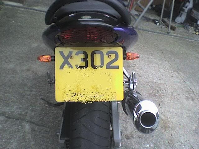

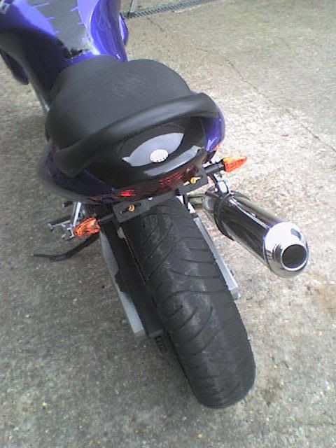

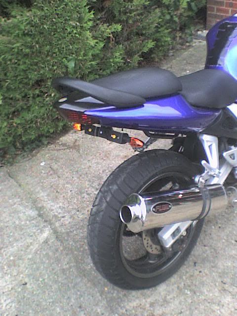

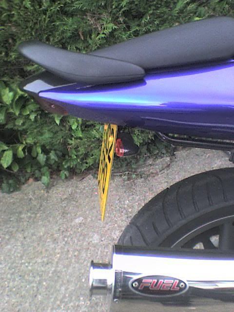

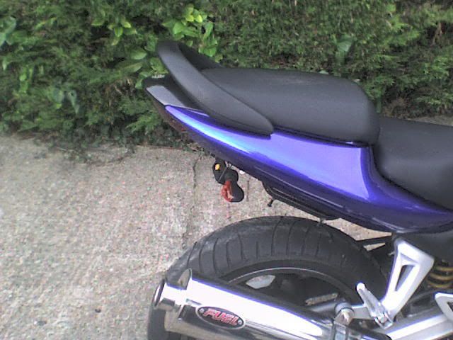

Wideboy 03-02-08 01:16 PM
Re: My **** - tail tidy

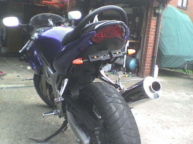

okay dokie its all finished, but i defo need a smaller plate as i think you will agree :lol:

EDIT: i used the template from >>>here<<< i only used the template as i decided to make my own tail tidy ETC, i read through his instructions to get the gist of what i needed to do

Top job. And yes you are quite right, a smaller plate will make the world of difference to the look. A nice 6x4 is what you need. :wink:

making it out of stainless would be a better idea, i chose ally as its easy to cut etc but if its not primed and sprayed properly it will corrode up as soon as the road salt touches it.
i used the original numberplate bracket simply because it was there, i sanded it down and re sprayed it, then cut the brackets for the indys to bolt onto and they are held on by the same bolts that hold the numberplate one

also its probably better to make it out of 1.5 - 2mm, i used 3 mm and it was a pain in the ar5e to do the little bend in it
i clammed it to the bench and put all my weight on it and it barely moved, i resorted to sitting on it and jumping up and down :D

oow oww and another thing:), on the bit i circled in the pic, you want to bend a slight upwards curve in them so it all sits flush when held up fairing
http://i102.photobucket.com/albums/m...DSC00676-1.jpg
thats all your getting, i dont want to be rendered completely useless ;)

printed off the template, stuck it together (bigger than A4), stuck it to a bit of 3mm ally, cut it out with a jigsaw, filed it, bent it and played about untill it fitted perfectly, sanded it with 240 grit paper, cut out and assembled the tail tidy bit using the standard plate bracket, sanded it, riveted the tail tidy to the undertray, primed it with etch primer then sprayed it mat black, fitted mini indicators, wired them up and then fitted number plate
think thats everything :D

i got my ally from a metal stockist round the corner from work, it was an offcut which only get chucked so i asked if i could have it, plus i made something for him few days before :p.
as the the MOT, I'm going to get a smaller plate (not done it yet:oops:) then stick a reflector on the bottom of the standard plate and keep the original and swap them for the MOT's, as for lights, like chris said, wouldn't bother, when you have the lights on the tail light illuminates the plate so the likelihood of you getting pulled for not having one are virtually nill.
only bit to be careful is when cutting away the old undertray, my advice to you on this would be cut a little bit then hold up the one you've made and so forth, i got a little trigger happy on the grinder and took to much off but luckily its not noticeable :rabbit:
