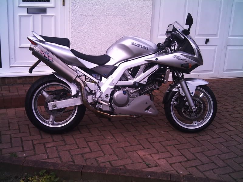

No long term problems as the can didn't shake about, to busy looking forward anyways :D. Hi mount had little more movement as the bracket was mounted further down as you can be from my picture attached, but still it was okay
http://i143.photobucket.com/albums/r...n/PHTO0003.jpg
http://i143.photobucket.com/albums/r...n/PHTO0002.jpg
