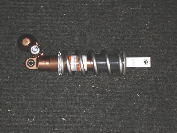

TheShadow 16-09-09 08:38 PM
Re: Rear shock for curvy?
My shock Definitely looks like a 2008 shock. Here is a pic before i installed it.
I dont think it is duff as it does absorb shock pretty well. I.E if you where to bounce up on down on the bike it settle pretty quickly no wallowing or "springyness"
http://www.westminsterltd.co.uk/100_1190.jpg

Lucas 16-09-09 09:20 PM
So it's better then a stock anyway? It should suit a 11st? :D
