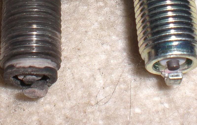

Bike was runnig a bit rougher than normal so it seemed new plugs might be in order. Imagine my horror when I found out I hadn't replaced them in a year or 12,000 miles.
My question is: What, if anything does the plug from the front cylinder indicate?

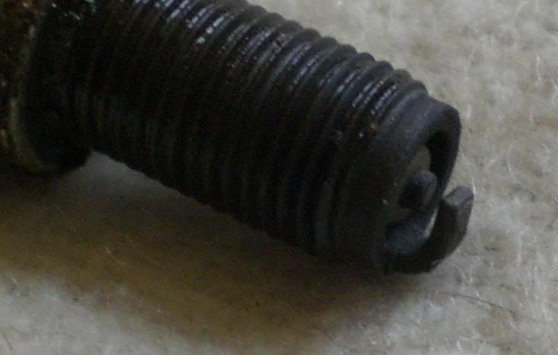

Next to it is a new one, and the pic below that the rear which seems ok if not a little sooty.

Front one looks just well used to me,rear looks a bit rich.No oil I take it? Rear choke plunger OK?

There are some pics in the very back of the haynes manual.... I'll have a look and see if I can match it up.
EDIT: its a match with Normal and a little bit of Worn. FRONT
EDIT 2 : the REAR plug is "Carbon fouling - Dry, black sooty deposits leading to misfire and weak spark. Caused by an over-rich fuel/air mixture, faulty choke operation or blocked air filter.

Well I've just changed the choke cables today actually, together with the throttle ones. Probably never run again. I was told that the choke on one may have been sticking. Trouble is, after all that effort the old cables felt fine.

Doesn't the rear cylinder run hotter than the front?? That might explain the difference!

Bit rich, your's is quite free flowing setup, are you using split mains?
Can't see the colour of the insulator nose on the front plug, would be helpful.

If its taken 12,000 miles to get to the point of running rough, I'd say it's alright, a set of plugs a year isn't going to break the bank.

Cheers BB and DD
That sorta put my mind at rest, although I was thinking that the front was the problem not the rear.

This is a complete guess - but might the front cylinder run slightly cooler because it's exposed to the elements and the rear one isn't?

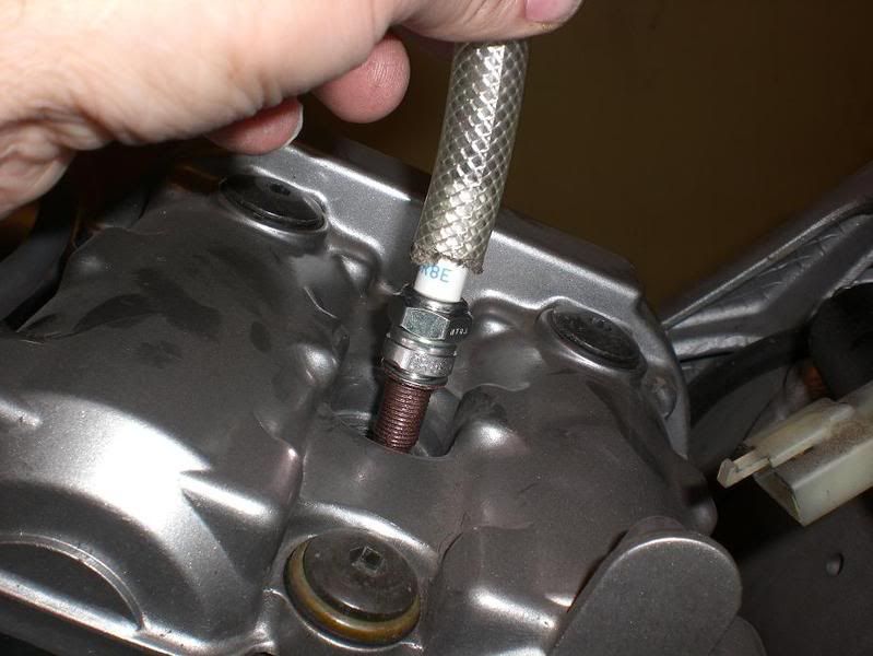

Berlin
Default Re: Plugs. What's wrong with this 1?
That's a great tip with the piece of hoze holding the plug! Not seen that one before! I wish I'd known about that when I ran the FZR 400! They were a real bugger to reach!
Thanks for that!

IfI remember correctly, the rear cylinder is supposed to run slightly richer than the front one, because the front gets the benefit of a lot more air around it. If you think about it the rear cylinder is actually quite enclosed, and probably gets a lot of the heat from the front cylinder thrown its way!
They had a lot of trouble with the rear cylinders on the vfr's overheating because of this, even though they are also water cooled.
