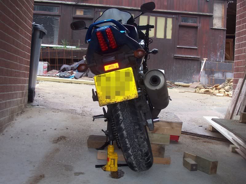

I decided to not post this in the thread, but provide a link... http://i103.photobucket.com/albums/m...s/100_1622.jpg
That's how I've got the front off the floor in the past. Build the wood up, foot on the side stand, hold front brake, lift rear of bike.
For extra stability if you wanted you could put something under the sidestand. For sorting out those forks you'll want the bike pretty level, so get your friend to help out!!
NOTE: I don't advise those with a heart condition, or too much affection for their bike do what is shown in that picture.
