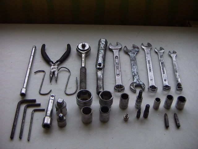

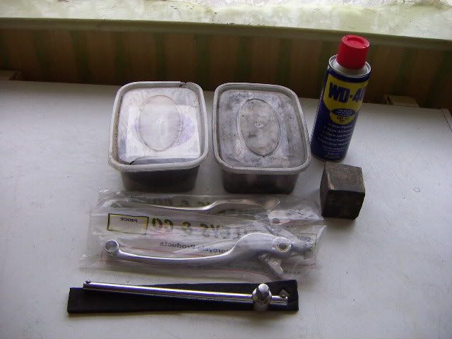

I ditched the standard toolkit and using two chinese meal containers made up my own. All the below is just under the pillion seat.
WD40 200ml size
Spare clutch and brake lever
3/8" drive t-bar
Block of wood for front plug removal
Container No1 : Spare bulbs and fuses including the small type fuse for alarm
Road tax disc
Container No2: 8,10,12,14 combination spanners
14/17 spanner
OE Plug Socket
1/4" Rachet and long extension
Pliers
Coat hanger wire bits to support calipers when off.
3,4,5 allen keys
short 3/8" extension
3/8" to 1/4" adaptor
22,19,14,13,12 3/8"sockets
Valve extractor
4,6,8 & 2 cross head bits plus 1/4" adaptor
8,10,12 1/4" sockets
Plus various length cable ties slotted around the rear fairing
Hope that gives you some ideas

petevtwin650
Default Re: What's in the tool kit?
Yes some good ideas.
Levers can be bought as a set off of e-bay for £15 plus postage, but I went into my local small bike shop and he did me a set for 18 quids. Well worth carrying to get you or a mate out of the poo.
Bungy straps are ok but a bit bulky. What I have under the riders seat are some luggage straps. The type that go around suitcases. They are about 30 cm long and you can join them together. Very useful for holding on bits that have fallen off. Use a cable tie to keep them compressed when not in use.
