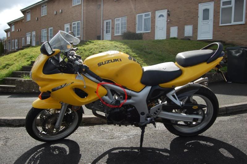

Where EXACTLY is this disc? I had a brief look (but it was fookin' freezin'), don't want to remove lowers unless I have to to get to it..

I cant remember exactly, but its on the LHS, It pokes out either just under the fuel tank or in one of the sections of the frame.
Its a black plastic knob, not a disc, somewhere in the area I've put a red circle on in the pic below

Yeah found it! Excellent! Ill see if it does its job the next freezing morning we have! Thanks a lot for your help guys!
