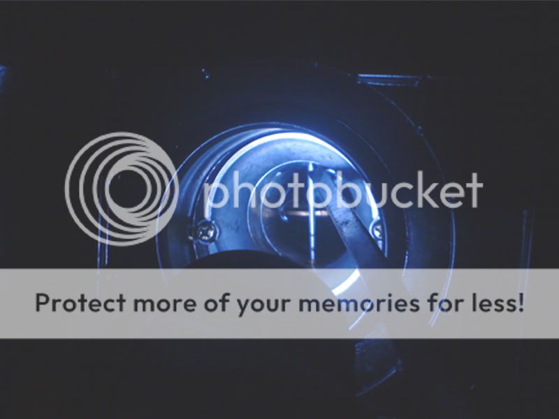

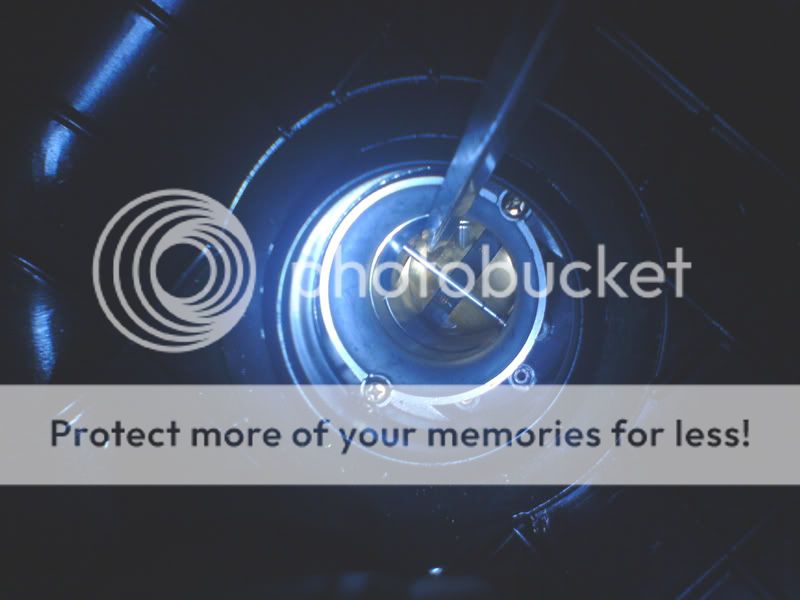

Put bike away two days ago all happy, Went to check it today and i saw fuel under the bike a small pool and it smelled pretty bad of fuel too. So i took airbox off for a better look and found the front carb was full of fuel and leaking but the rear one is fine as normal? Whats up with that, am i looking at new carb diaphragm or somthing else before i take carbs off. Does an sv have a fuel prime setting or somthing like that that would cause carb to fill up. Heres a few pics if they help.

Float or float needle sticking is the obvious likely cause.

Gotta be. Also maybe dodgy vacuum tap as that should stop fuel flow.
Definitely take the plug out and disconnect the coil in case it's hydrolocked

Please do not turn the engine over without removing the front spark plug. There's a chance that the front cylinder is full of fuel (depends what stroke it's on). Fuel doesn't compress all that well.
And yes, you'll be stripping the front carb & possibly the fuel-c0ck if that's not cutting the fuel flow when the engine's off.
