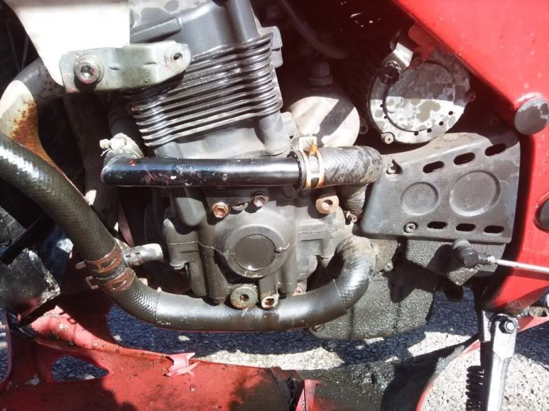

my brother has a rf600 he had a accident on the bike a few weeks back did a bit of damage to the left hand side he has now after getting the all clear on his hand has started to look at the bike
the bike has an oil leak coming from the hole at the bottom of the engine see photo, does any one know whats meant to go into the hole i have not seen the bike in flesh to have a look yet

it's a plug and washer from an oil gallery, of course without it it'll leak.....

can you read them part numbers for them mate?
cheers
Old 08-04-10, 07:15 PM   #5
sunshine
Default Re: rf600 help please
09168-100002 part 33
09248-100007 part 34
I think it looks like that anyway
Old 08-04-10, 07:21 PM   #6
rictus01
rictus01's Avatar
Location: South London
Posts: 9,799
09168-10002
09248-10007
is correct.
Old 08-04-10, 07:22 PM   #7
ricky
09168-10002
09248-10007
is correct.
thanks you kind sir
