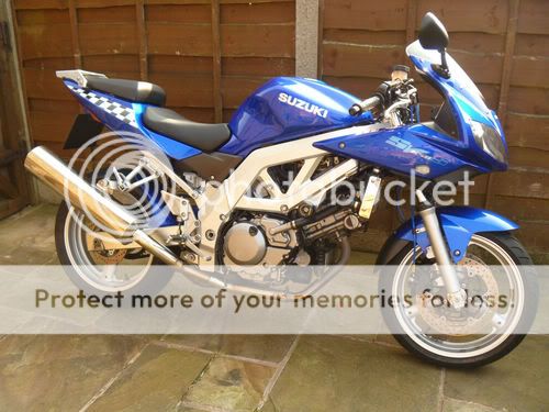

I have done around 200 miles today on the new bike, Very uncomfortable to say the least. Can anybody tell me if the seat in the picture is a low seat? Or is it what would have been on originally? I will definatley think twice before i do any motorway miles again! The lunge thing all makes sense to me now!

Yep its been scooped
The original is flat
Old 07-05-12, 04:07 PM   #3
Bibio
Bibio's Avatar
Posts: 11,568
Default Re: Is this a "low seat?"
nope its the original for K3-4 as the subframe was higher so less loft at the back. scooped sets are more scooped at the front

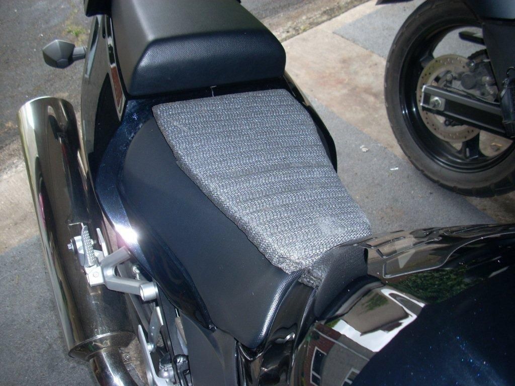

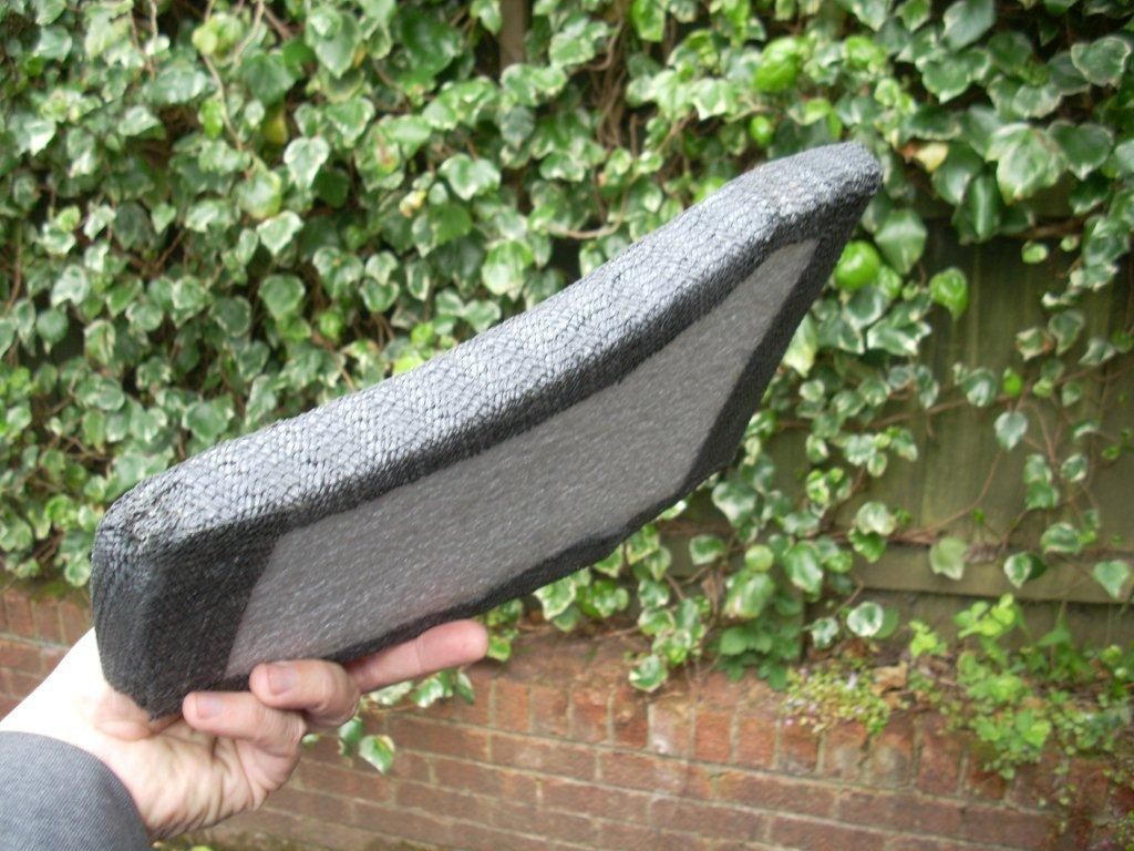

Well here's my solution - love it or hate it. I find the 800mm on my 2011 a bit low so I made a pad which is 20mm when compressed giving me a nice height rise. Made from two thicknesses of packing foam with a nonslip mat contact glued to the surface. I have ridden it for 50 miles and for me the handling of the bike improves. If you like to slide around on the saddle then it would be no good. I prefer to be planted around the tank. The non-slip mat makes it very safe without ties - you would be hard pushed to slide it. It could be used as a prototype to see if you like the new height. You could then get another seat made, buy a cheap original off ebay to remove staples and add packing or do this to your seat. Don't know if the commercial padded seats are higher but mine works great for me. When I stop it slips over the back wheel where a hugger might be and is virtually invisible to nosey eyes! Love it or hate it, as I say this is just one (cheap) solution to the problem. Pics here:
