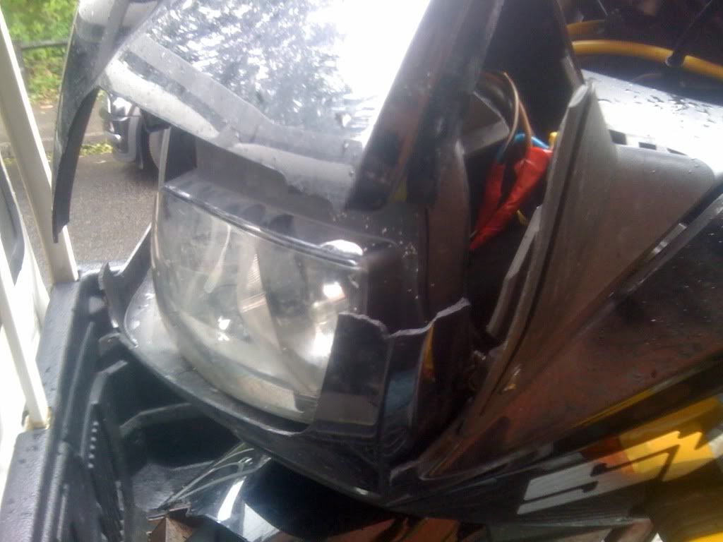

just thought i should say that i am looking to do this mod after i crashed my sv into a mates tdm when he came off in front off me. my old boss (a bike mechanic i should add) says the forks are probably bent but hes unsure. and being a mechanic myself ive gave them a quick looking at and they seem fine. when im riding theres a clicking at the front end when i brake (probably head bearings mashed from the crash) but i havent had a propper look at anything. ive bodged on a curvy radiator that i got cheap and have been riding it since (about 2 months ago now) but i need to start doing the bike up. the front fairing and headlight was smashed so my mate glued them for a quick fix. i have sourced a whole front fairing (front fairing, under tray thing, screen, mirrors, indicators and head light) but although being described as like new is almost as bad as the one on the bike (repainted badly and cracked). so i am now thinking of vinyl wrapping the whole bike. i also need to get hold of a radiator which is proving to be very hard. if anyone has any advice on what they think i should be doing please feel free to advise.

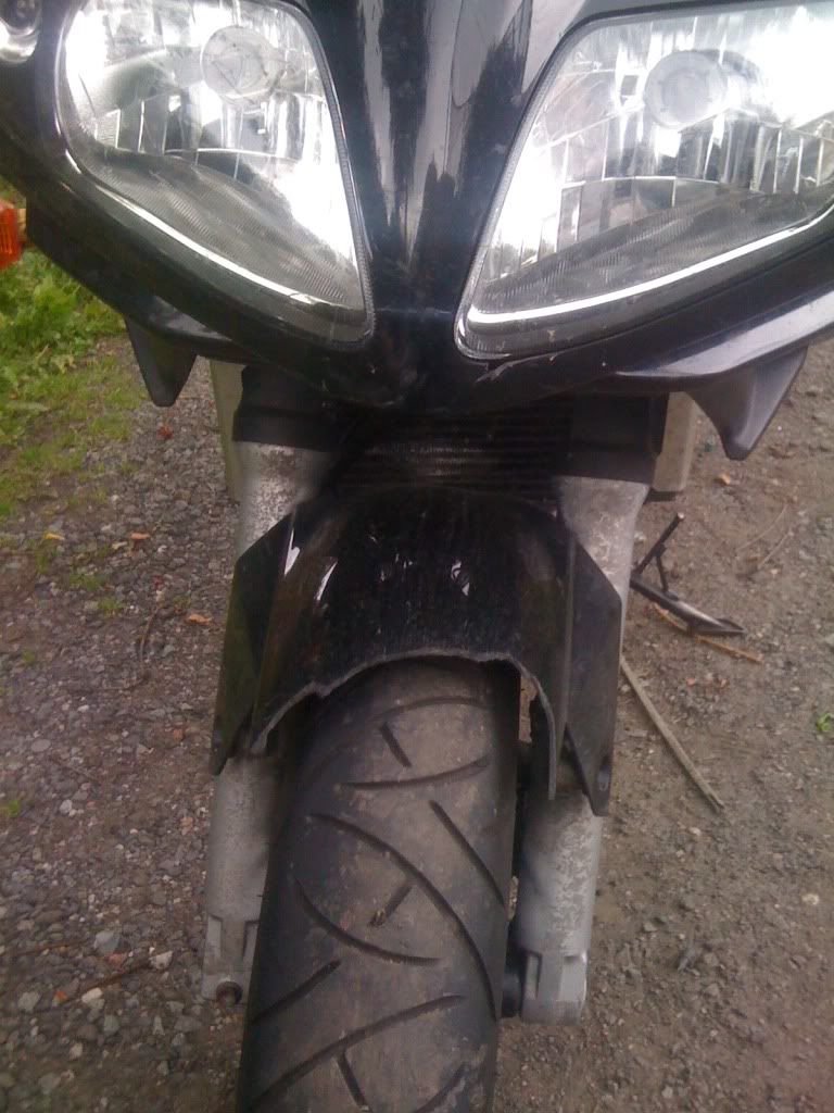

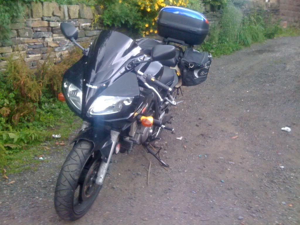

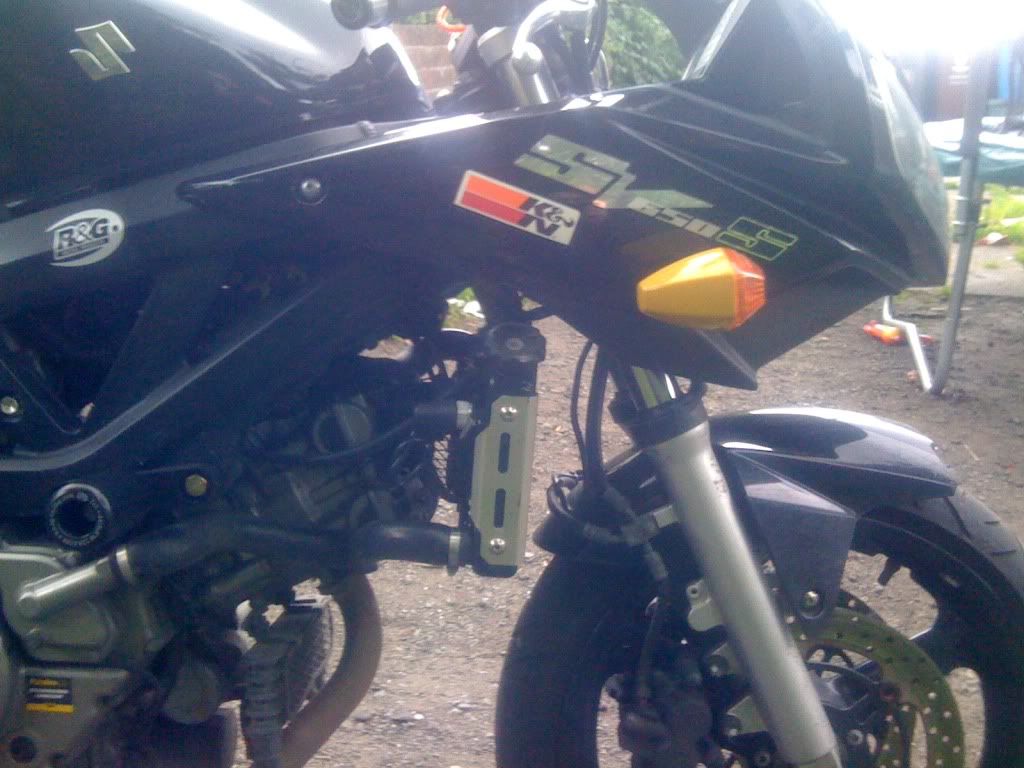

I think I have found the source of the clicking at the front end. the thing that was throwing me off was it didn't always click when I braked. only when the suspension travelled a certain amount under braking. but I think the bodged on radiator is catching the front mudguard. so no big problem. I haven't cleaned the bike since I crashed it cos I just haven't been bothered to do nout. so I think im going to clean it up this weekend and take it down to my mates garage to get it fully checked over so i know what needs doing. I know it needs a new radiator, a new back tyre and i need to swap the nose for my new one. so for now the front end is going to have to wait. while there seems to be nothing wrong with the forks i want to upgrade them anyway as i found the stock ones very poor when i was riding the bike hard before the crash. in comparison to the bandit i had before it is shockingly bad. although hearing they are longer puts me off a little as i have had the rear of the bike lowered and it is still to high for me.
well here are some pictures of the bike. first one is the earliest picture I have of the bike before the crash. then there are some just after the crash. the rest are as it stands now.
