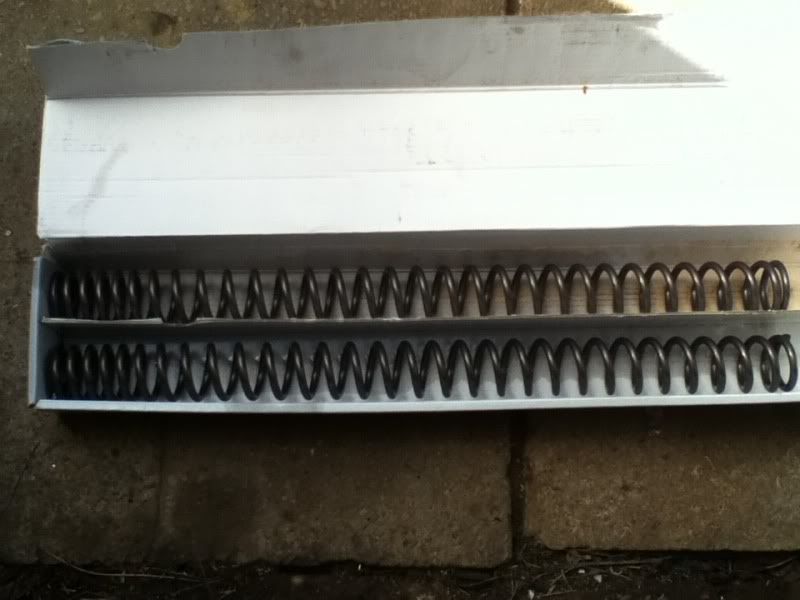

Old 25-05-12, 07:15 PM   #8
britaxcooper
Default Re: Identifying Hagon springs - how?
Here are the pictures of the springs, as you can see the progressiveness of the coils are only very slight when compared to the first pic of this thread.

Old 26-05-12, 07:42 AM   #10
muzikill
muzikill's Avatar
Join Date: Jul 2005
Location: Dunfermline
Posts: 1,712
Those look like the stock pointy sv springs the original hagons that were in those boxes replaced btw.
