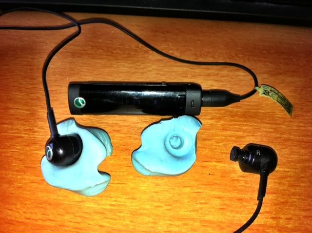

No idea if any of you have already got these, but I was looking for a way of listening to music on the bike while not damaging my hearing (long motorway stints). These are plenty of companies that produce custom fitted headphones, but they are expensive and involve a trip to an audiologist.
I always assume I can do it cheaper. So I did.
First up is to buy a DIY silicone ear plug kit:
http://www.ebay.co.uk/itm/Custom-mou...ht_1470wt_1396
Good for 2 pairs.
Then you need a set of the newer style in ear headphones - the ones that come with several rubber tips and fit inside the ear canal.

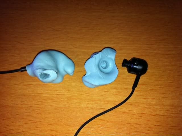

Follow the instructions supplied with the earplugs, and insert the headphones into the plug before it sets. Make sure its in far enough to not foul on your helmet while putting it on. Wait 10 mins, remove.
Remove the headphone and clean any extra material out of the tube. Drill from where the end of the headphone tube went into the plug to the end of the section of the plug went into your ear canal.
Rinse and repeat.
In order to satisfy the bluetooth requirement, I bought one of these:
http://www.amazon.co.uk/Sony-Ericsso...7164108&sr=8-1
The headphones supplied with it are suitable.
Now I can listen to music (track skip and volume works with iPhones), get sat nav instructions etc from my phone on the bars. Plugs are comfy so far and decent at "motorway Speeds". Not tried taking a call on the device yet, the bluetooth unit doe shave a mike so it should be possible. More use for quick calls while stopped probably, not sure i want to be on the phone while riding a bike.
I'll get some photos of the finished product up tonight.
There is a video here of someone doing the same thing:
http://www.youtube.com/watch?v=lmk-y_9exJ8

great stuff..always up for a bit of diy. I wonder how they stack up when you are pulliing the helmet on and off.
Any low profile ear buds out there? Look forward to the pics and review.

I got the left earphone one pushed in further, works well. The right catches a bit and I sometimes need to give it a tap once my lid is on for it to sit perfect.
Pics are up, should be able to see what I'm talking about.... Still got half the stuff left, will make a set of plain plugs as well I think.
