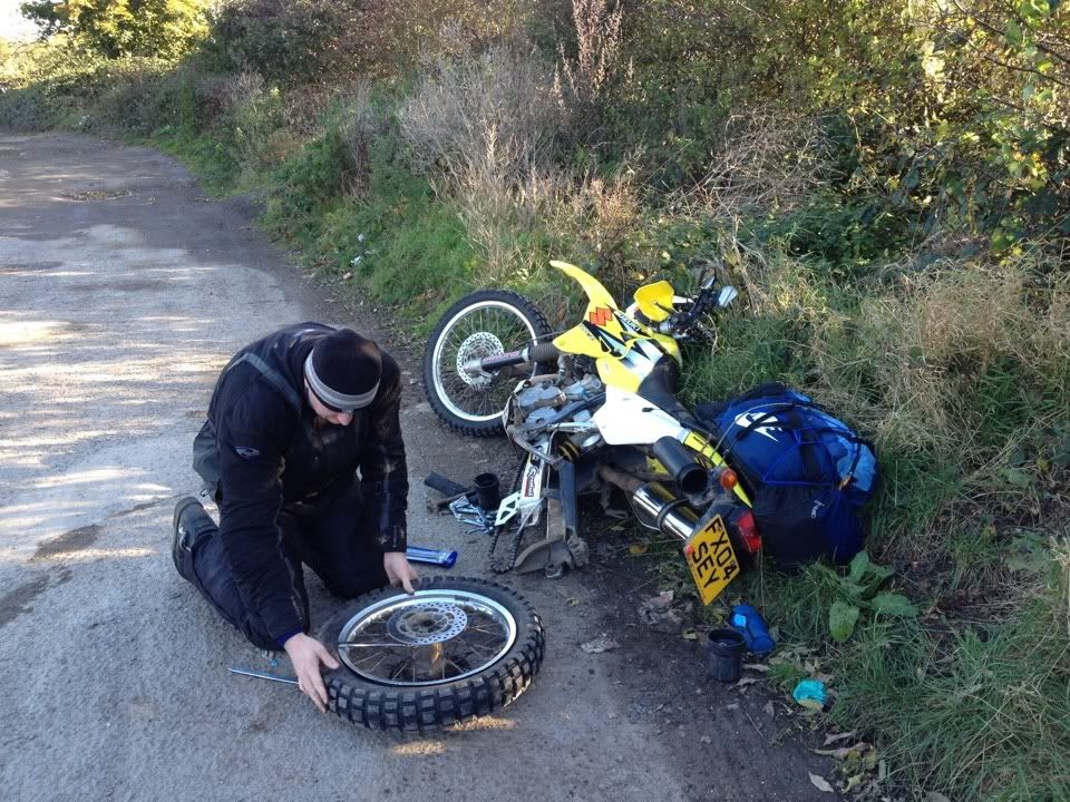

Been for a little camping down Preston on wye, on way down yesterday, doing 70 ish, suddenly back end comes round on me at an angle while going in a straight line, I didn't panic or brake, just tried to keep it straight and slow down gradually, really thought I was gonna be Tarmac surfing at one point.
Anyway after inspection, found my valve had completely blew out of my rear tube, followed by rapid deflation, no warning whatsoever.
Aliwakeskate helped me change on the side of the road, luckily there was a bike shop 3 miles away, within about a hour or so we had it fixed.
