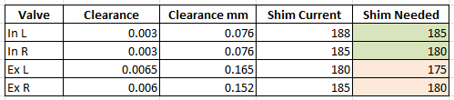

Need some advice. First off, like a total Muppet I turned the motor clockwise by about a revolution. Will this have caused me any problems?
I have since seen sense and turned the motor anti clock like it should be a few times to check it, and then I have set the R up in the timing inspection window and checked the rear cylinder.
Next problem: my feeler gauges are imperial
So far I have this:
Ex L: .006"
Ex R: .006"
In L: .003"
In R: .003"
Specs are:
Intake: 0.10mm - 0.20mm (0.004" - 0.008")
Exhaust: 0.20mm - 0.30mm (0.008" - 0.012")
If my readings are right, I'm going to have to do all 4 valves yes?
So assuming I have not screwed anything up winding the motor backwards, do I go ahead and strip the motor or would anyone say its marginal enough to just leave it?
BTW, its done 33k and this will be the first check on the clearances.

Yes, you'll have to do the lot - they're all tight.
Imperial gauges aren't a problem; 4 thou = 0.1mm, or at least closely enough to do this job just fine.
As long as you turned the motor the right way a couple of turns before checking anything it'll all be fine.

Right - can someone shout at me if I have this wrong please?
Looks like I only need 2 shims, and a cam chain tensioner gasket.
I ziptied the chain to the cams so I don't need to fix the timing later - seems to have worked.
And these look to be the right shims (7.48mm dia) - http://www.ebay.co.uk/itm/Valve-Shim...item337fcb48fe

i'd set the gaps closer to the upper limit.
No no no.
Definitely check it. 100% don't omit checking it.
The cams may be correctly spaced apart but the chain may have rolled around the crankshaft end sprocket.
Check the timing!
