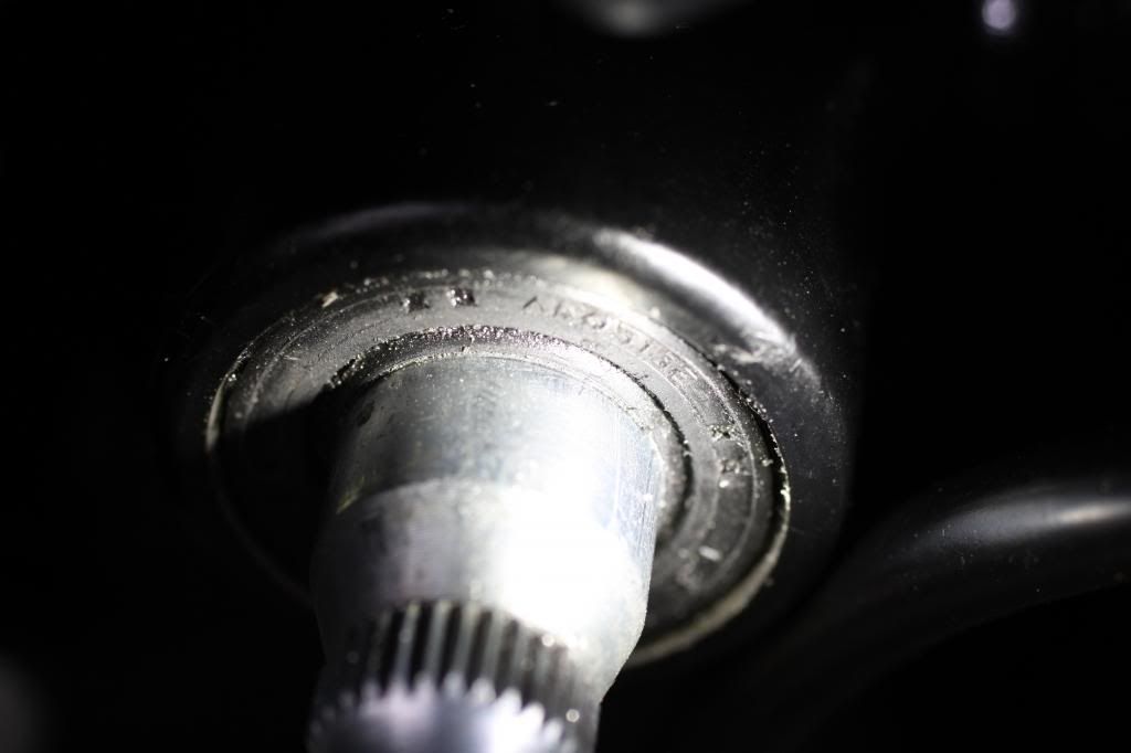

O.k so some of you know a few gears on my ZX-10R decided to go all big bang theory on me and shatter. Stripped the engine out and sent it off to repair...
So, over £730 later for the repairs and spares, and £100 in courier fees I got the engine back and fitted it. (without a jack, hoist or even an axle stand i might add )
It was when I came to fit the gear change lever onto the splined shaft I noticed this little beauty.
YouTube Video
Apologies for the poor quality, apparently pixels and picture quality are not high up on the list of must-haves for my HTC.
Yep, it's not suppose to do that. Apparently a circlip and washer were missed off post repair. So I ring up and the bloke is very apologetic and agrees to post them there and then. This was thursday morning. So friday comes and goes, as does saturday and then finally yesterday with no sign of the bits. After a quick phone call I am told the bits were not sent as the washer is on back order from Japan, with an estimated delivery date of August 27th!!!
**** me I was annoyed. Complete lack of a phone call or anything on there part. Wish I hadn't stumped up the cash in the first place until i'd checked everything. Anyways, rant over.

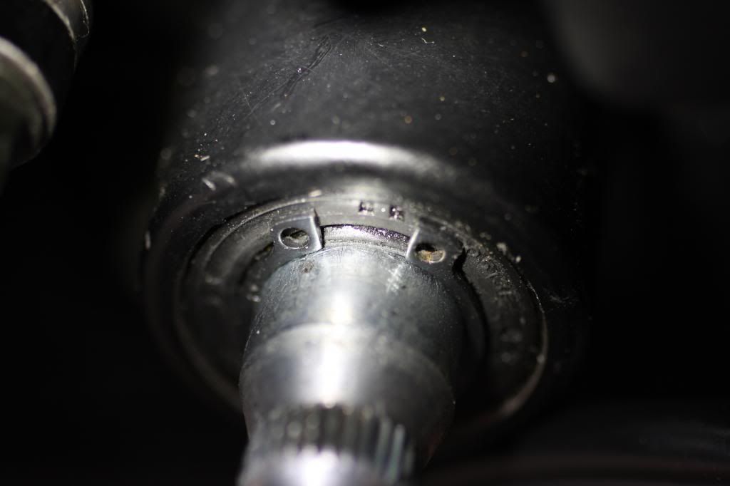

Cheers Matt, well the circlip arrived today but much as I thought, the shaft isn't pulling out anywhere near enough to reveal the groove it should sit in. When the bloke rings me back I am just gonna let him deal with it.
With regards to the clunky first gear selection, apparently 'they all do that'. Seems to agree with what people on the ninja forum say but i am no longer confident it's the whole truth.
And for all those who are thinking 'why the **** is he moaning just fit it and get on with it'
Here is said shaft with said missing circlip groove.
et voila..
Bearing in mind there is supposed to also be a washer BEHIND this circlip....
Clearly, something's not right.
