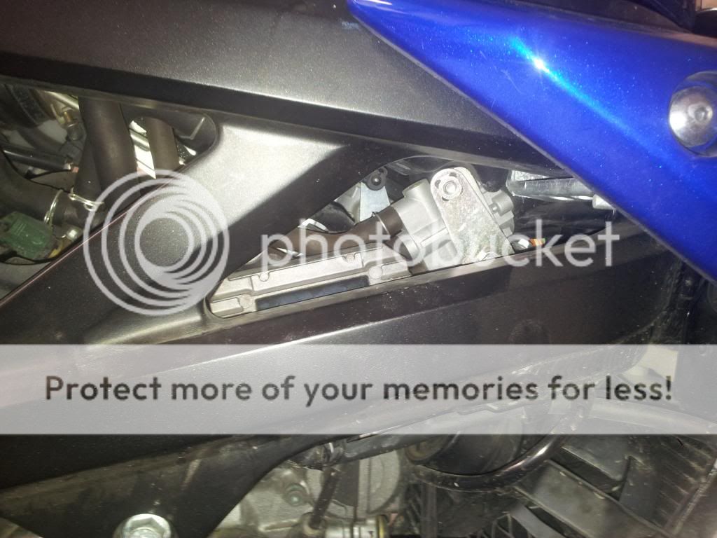

Thx Sid. Just to make sure I'm looking in the right place, the regulator is on the right side of the pointy in a very hard to get at place that makes it awkward to work at:
Old 27-07-13, 07:20 PM   #7
Sid Squid
No, I don't lend tools.
Sid Squid's Avatar
Posts: 8,680
Default Re: Pointy charging system problem.
You don't need to get to it to check it - just it's connector block.
Old 27-07-13, 08:13 PM   #8
scully19
Ya but unfortunately that is just as difficult to get my hands on to be able to pry it open it seems. At least I'm at the right spot though. Thx.

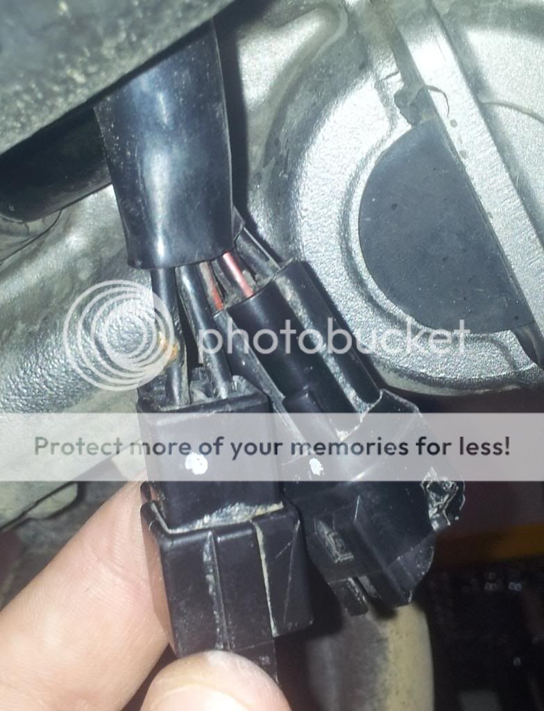

Old 27-07-13, 11:56 PM   #9
scully19
Well pretty sure I found the problem here:
That wire looks like it melted a bit. Problem is it isn't all the way through it so the cable are still technically attached. I did all the test you are supposed to do and they ended up passing, I believe because the wire is not completely severed. Am I correct in that assumption, and also that under full use it can't handle the load and thus fails, and this is still the problem?
Also, you think I could just solder the cable back together and use it as is?
Lastly, as I see in your signature, you are making fun of that mod. Do you think it is unnecessary to do that, if I need to replace my regulator anyways do you think it is a bad idea, I've obviously read a fair amount about it around a bunch of places.

Old 28-07-13, 01:22 PM   #10
wideguy
Obviously something wore through the insulation and resulted in a short circuit. Perhaps intermittent, perhaps not. You could just tape it up and try it.
