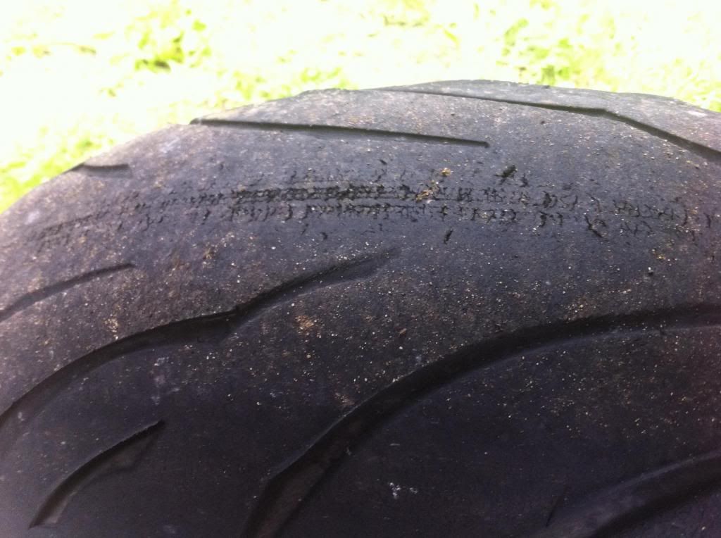

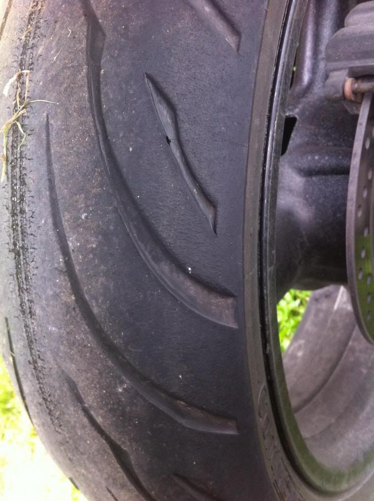

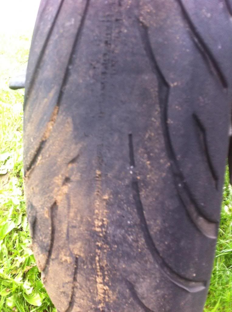

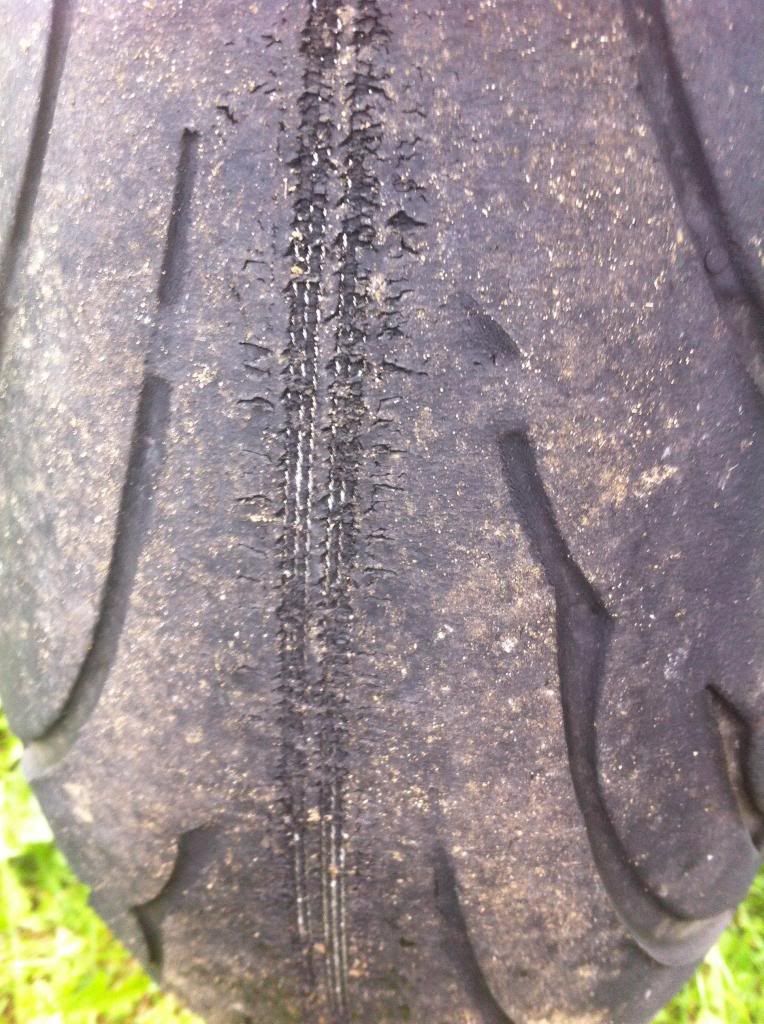

Is this age related or should I lay off the right wrist action?

lay off the straight roads. Quite concerning how close those threads are to the rubber surface looking at the wear markers.
Was the tyre being run with the correct PSI in it?

That's what I thought. When I left this morning I had about 0.5mm over the wear indicators and thought "oh these'll be fine for another 500 miles..."
70 miles later they were like this, stranded in the middle of butt f*ck nowhere. (Marlborough in Wiltshire outside a pub)

The last bit of the tyre is softer than the main body. The bit before the canvas is moulding rubber.
Pirelli's are bad for it

PSI maybe too high. I would expect that wear to be over a larger surface area.

Nothing wrong with Continental tyres, that one is knackered however, but it really doesn't look like normal wear to me. I suspect either a manufacturing fault, or damage from prior running at the wrong pressure.
