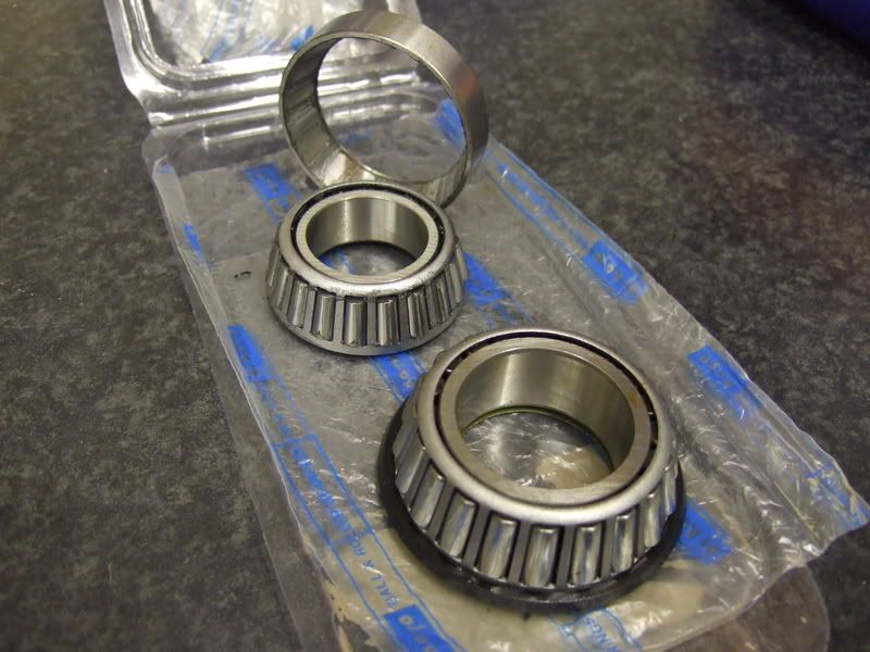

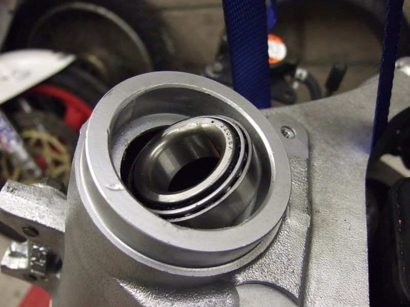

I'm putting on new head stock bearings. The old ones that came out of the frame are the same size as each other and look like this:
The new bearings are tapered bearings. I ordered a kit for the bike but the bearings are different sizes to each other. One is the same as the standard size but one is smaller:
Have I been given the wrong bearings?

I don't understand how it works then, cos it is way too small to fit

Yours pointy?
I seem to remember the late gsxr yokes being a direct drop-in replacement on the pointy, the gsxr srad used same bottom bearing as the curvy with another as the top bearing too.
Maybe they've sent you the curvy fitment.

Yeh its a K3. The yokes and bearings are the same size as K4/K5 gixxers.

IMO you've got curvy bearings there

yes the gsxr k4/k5 bearings are defo the same i used them on my pointy.

looks like curvey bearing, as said

Right I'll need to swap them on monday
