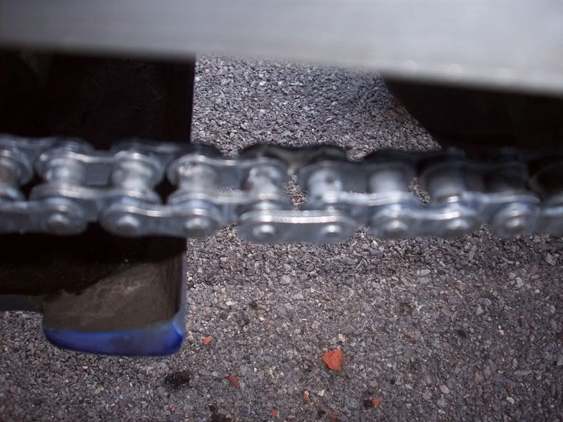

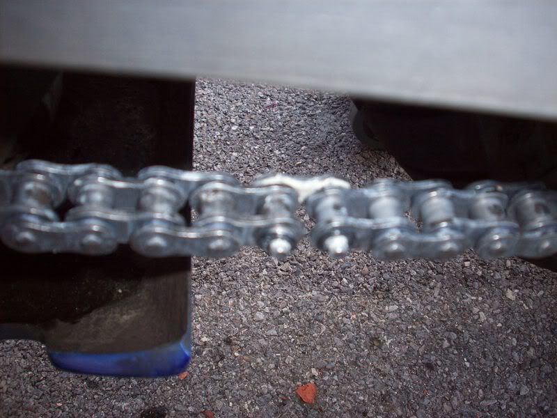

Im using the spring link, so i can take it to get rivitted. but I cant get the plate on! As far as I know it should just slide on easy.
this is it without the second plate on, looks normal, space for washers etc
and here it is with the plate put on, it wont go on further, leaving no space for the spring link and a gap behind it.
can someone please help me out, I really need to get it sorted today while the sun is out!

I cant see the pics as im at work, but you have an o ring either side and not both on one side?
Old 21-10-08, 01:11 PM   #3
pencil shavings
Default Re: Urgent chain help
yep, o rings on either side, but the plate just wont push on any further. if i didnt already have 2 sets of plates for the chain I would think it was a duff part....

The chain is a Izumi O ring

Good afternoon all.
Most chain side plates need pressing on, there's a special tool for this task. However a good substitute can be obtained by using a smallish G cramp, & a nut.
Make sure you press the plate on a little at a time via each pin, & that you don't press it on too tightly overall, & you should be ok.
Cheers.

Old 21-10-08, 02:39 PM   #6
pencil shavings
Originally Posted by Spanner Man View Post
Good afternoon all.
Cheers.
Thank you very much!! I have confidance but no knowledge!!
I off to get a G cramp (clamp??) and hopfully that works!!
