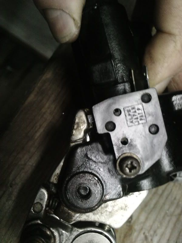

Default Re: aftermarket levers
Bought a brake lever similar to that last October. I have been having problems with the brake light staying on. Bought a new lever which is a different type & it's cured the problem. There was a load of play in the old lever & none in the new, more expensive one. Spose thats a problem with buying inexpensive pattern parts. Amnesia could have a point
Old Lever. Fairly big gap between lever & switch.
New Lever. Hardly any gap between switch & lever.
