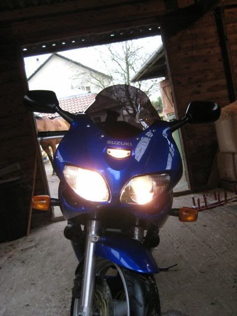

If it's an import and it's still got the overseas headlight unit it may well look like this
A projector type light in the right hand side. Our first curvy was like that and never had any problems with MOTs. Also it may not have carb heaters, but as the UK ones can be pants that's not much of a problem. I would defo want a Uk speedo though. Hard to read the dial with those little sticky on numbers, especially at night.
