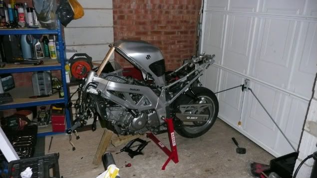

Old 12-08-10, 01:25 PM   #7
barwel1992
Default Re: Fork oil drain screw?
you'd need somthing like an abba stand then a jack just behind the oil filter
mine stayed like this for a good 2 month's
Old 12-08-10, 01:34 PM   #8
metalhead19
And whos fault is that

Old 12-08-10, 01:39 PM   #10
barwel1992
the bloke that didn't send the yoke
