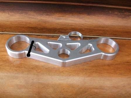

I needed a top yoke for the 750 forks,
So this morning I went to work, found some aluminium and set to work...
It's not quite finished but the trial fitting looks good.
I just need to machine the clamps and get it finished in some way.
Next onto the speedo fix.

How is it clamping onto the fork legs ?

Or do the clip-ons clamp to the legs then the clip-ons bolt to the yoke ?
I'm going to split the inside of the fork collar and drill & tap from the front.

and yes, the clipons bolt to the under side of the yoke

Oh I see , drill in from behind/front near the milled out triangle

Like this

Split it on the inside and then drill and tap through , maybe mill out a larger diameter so you can hide a cap head in there . I would also Mill it out from the ignition side to keep it tidy looking
