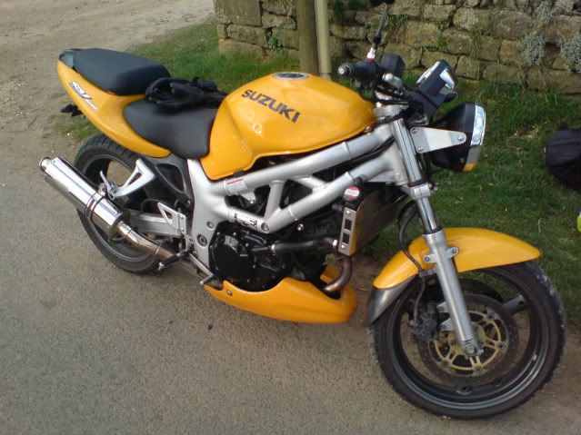

just incase anyone else comes along and asks this, we now have pichers
SV650 (other known aliases: SV650 Naked or SVN) - available in both curvy and pointy guises the naked doesn't have an upper fairing but instead has a retro looking headlight - to differentiate between the two, look at the frame and style of the tail...
SV650S "Curvy" - manufactured 1999 to 2002, also known as a "curvy" or a "Curvy S"
SV650S "Pointy" - Manufactured 2003-2009, this is the pointy "S"
SV650 Sport - Manufactured 2006-2009 (they only introduced the "sport" version in 2006 if i remember correctly?), this is the same as the "pointy s" but has a lower fairing and a plastic seat "Cowl" where the pillion seat should be (along with the grab rail removed, and clever little "infills" to fill the gaps....). No mechanical difference between the sport and the "pointy s", just a bit of plastic
Note: Pointy lowers will fit any pointy (2003 to 2009)... You can also get lowers for curvys & same rule applies)
Hope this helps
posted by me ages ago
