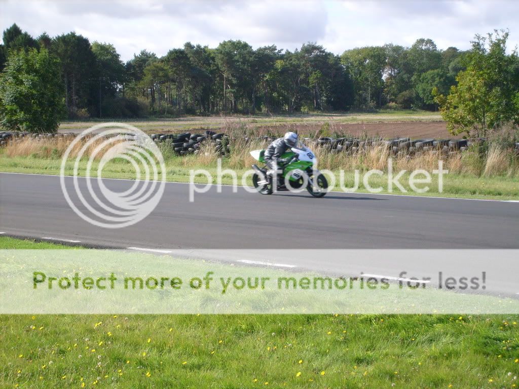

Default Re: Building a trackday SV. General questions.
here's what a couple of the fairings look like. I'm going through my photobucket for the minitwin fairings
Triumph 675 (the quality of the fairing was s***)
GSXR, excuse the very loud colour
side view
Nekkid (GWS you mad bugger!)
I you click on the photobucket link in me sig theres a shed load of photos of the northern minitwins
