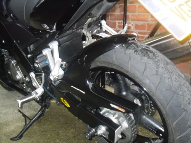

For those that have been waiting a long time (like me), Pyramid plastics have finally got round to making the huggers for the 2007 to 2010 model bikes. I got mine yesterday and they are excellent quality.

Hey!
Can you take a picture of the right hand side where your hugger is attached please? mine is on but seems dangerously close to the tire, so much so that it rubs a little.
Thank you in advance!

Loosen the bracket, move it away from the tyre, make sure the hugger is in the middle then retighten the bracket.

I have loosened the bracket, moved it away from the tire but it just springs back
should the plastic hugger be on the outside like on the chain side? so it would (from inside to outside) bracket, then plastic hugger and then allen key bolt? this would give me an extra 2mm?
Cheers guys, I never thought mounting this could be so painful!

Yeah, outside the bracket with plastic washers, so you don't see top of the bracket, you'll now see bolt end, plastic washer then the hugger with both parts of top off the bracket on the inside(nearest tyre(which you can't actually see)).
