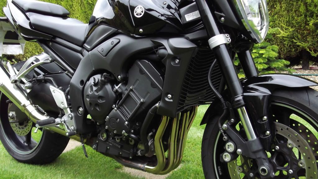

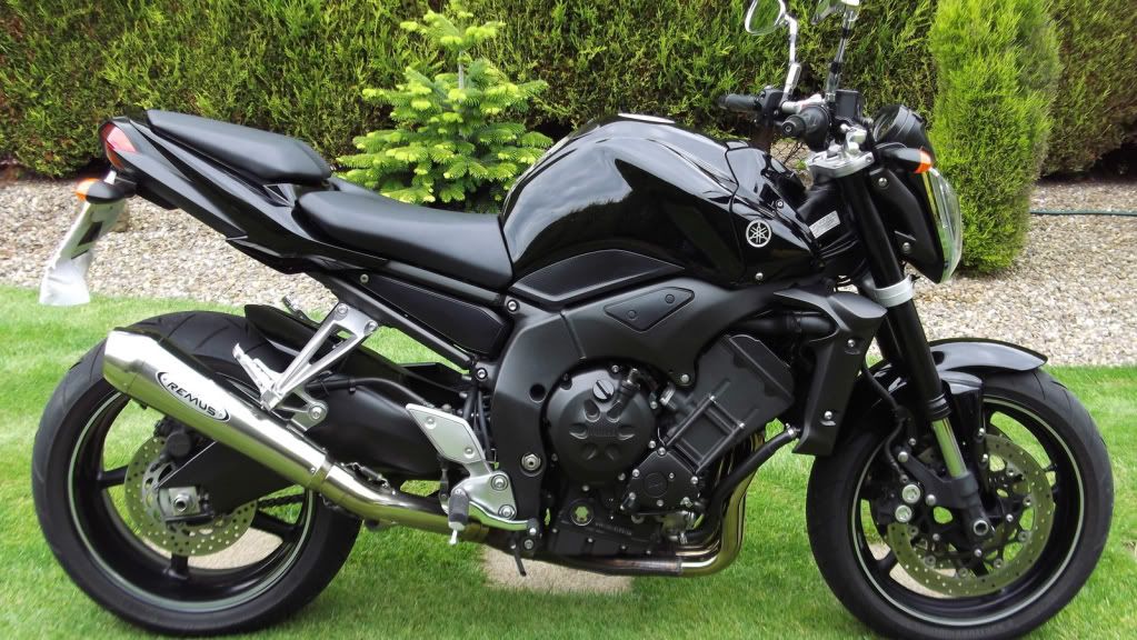

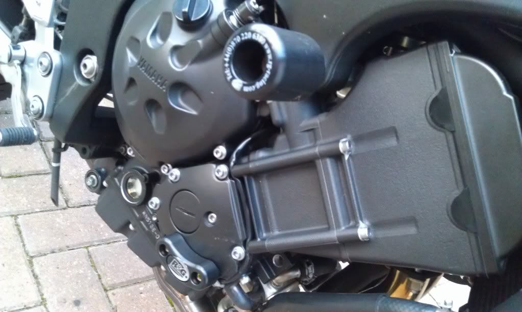

so got the bike last sat
its in showroom condition, but has a few niggles
Advert photos
so it has a crap tank pad, a remus powercone and a power comander PCIII usb,R&G tail tidy
the niggles were/are the power was verry lumpy down low and constantly popped on de accele and the indicators keep blowing the fues
the indicator problem has gotten worce so iv given up looking for the problem and ordered another wiring loom as my loom looks spot on but i know its the loom just not where
the popping issue was solved by plugging the air box feed to the AIS (air pulse system to the exhaust for emissions)
then i tried a few maps on the power comander but they were all the same lumpy down low, but i then decided to pull the baffle out of the exhaust and bingo it rant great
then i started tinkering with it, first i cut the air box inlet out as its stupidly restrictive, and then took a hammer and chisel to the cat, then mapped it again, decent improvement in the midrange and a huge kick when you hit 7k
velocity stacks from GB moto are in the post, then all i need to do it mod the secondary throttle butterflies and map again from what a few people say that should see near enough 150bhp at the wheel
as far as suspension goes iv set the sag and gone 2 clicks up on every thing, but think ill back rebound off on the rear shock (its crap)
at some point a ohlins will find its way on to the bike

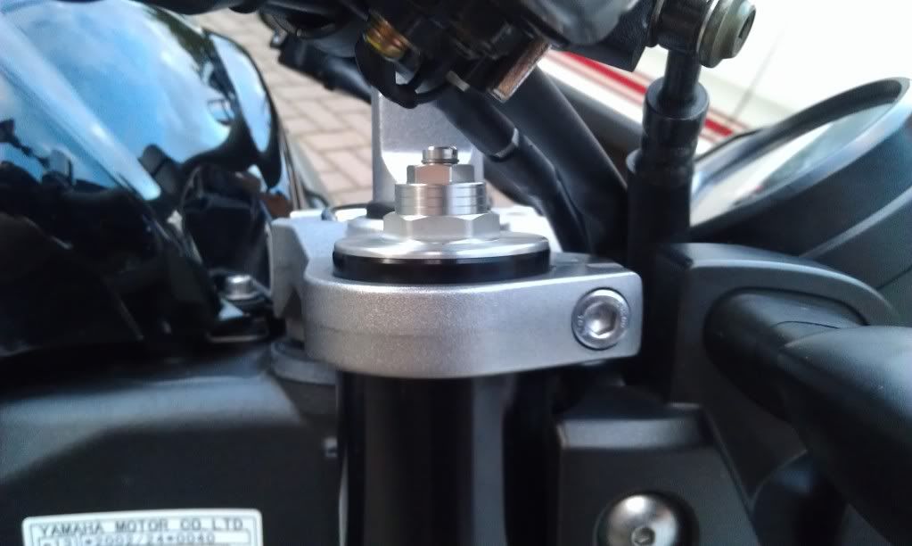

also dropped the forks in the triple clamps

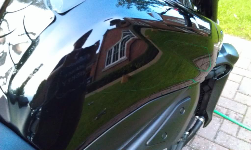

washed clayed,polished and waxed the paint

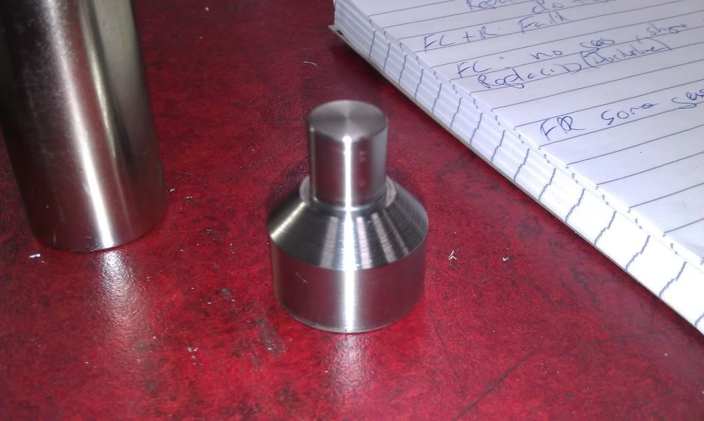

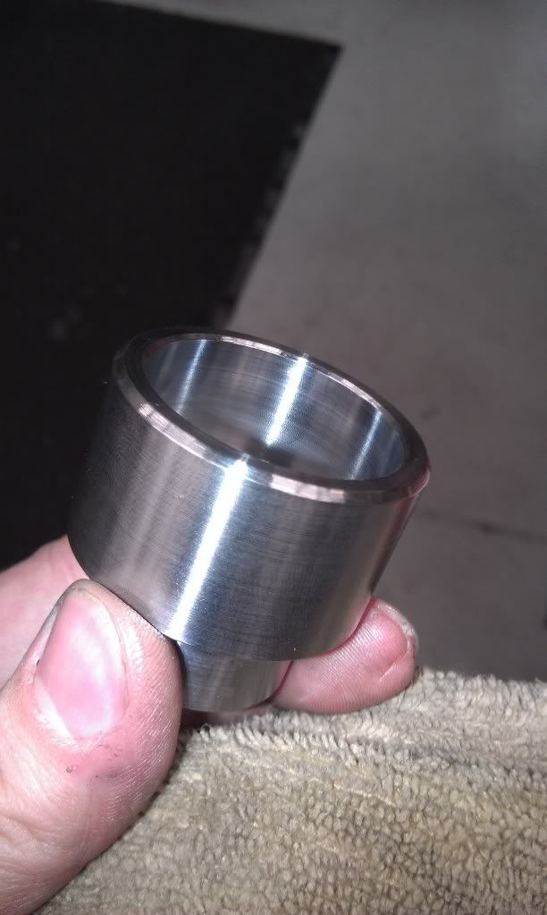

made my own bar ends, so i can clamp new mirrors to them
and made my own abba stand adapters beats buying them
and today fitted R&G's
