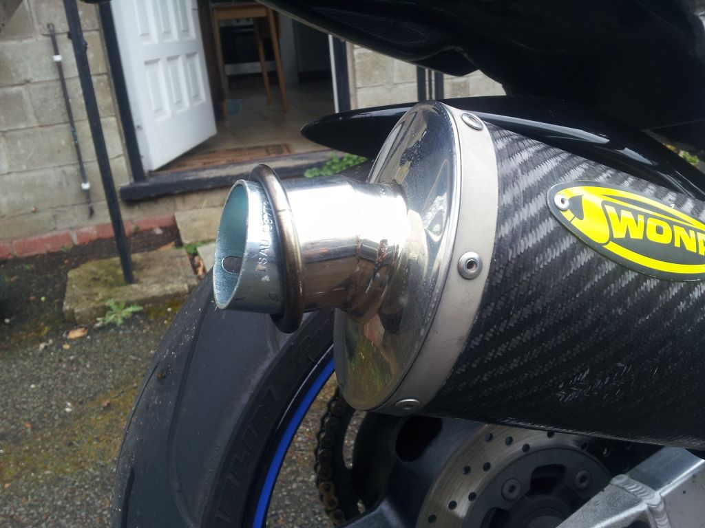

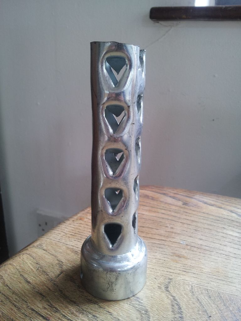

Thanks to Maviczap I can make a step towards not scaring the whole village when I go out on my bike. I am now the proud owner of this.
Problem is the can has a bit of a kink in the end so it won't go in
Any ideas on the best plan of action?

Cut a "V" section out and mig it back together

Reckons ya could still get a straight line into that. Get a rubber mallet and give it a good wack!

As NTEC says.....or if you can spare a fiver buy the right dbel killer for the can!

Company who made the can vanished a long time ago so unlikely i'll get a DB killer for it.
I was thinking it probably needs re-packing soon anyway so I could drill the rivets out, then take the end off and put it in from the other side. Only problem with that is it's a bit more permanent.

No ,just a universal kinked one.
http://www.bikedevils.com/bike-it-db...ay-16656-p.asp
I got one of them for £8 from local shop
However according to this, yours isn't 'wrong'
http://www.bikedevils.com/bike-it-db...ved-1509-p.asp

Cheers Dave, looks like exactly the same one as I have. I guess it just needs trimming down a bit.

Yeah, nice and simple - it didn't even cross my mind 'til I saw that. felt tip and a hacksaw and yer sorted

Or just cut the end of the baffle the same angle as the end of your can.

Don't ram it in you can damage the can /squash the packing.
If the packing goose your wasting you time tbh.
And if it sits in the middle it will be more effective.
Mind option 1 has my vote....
