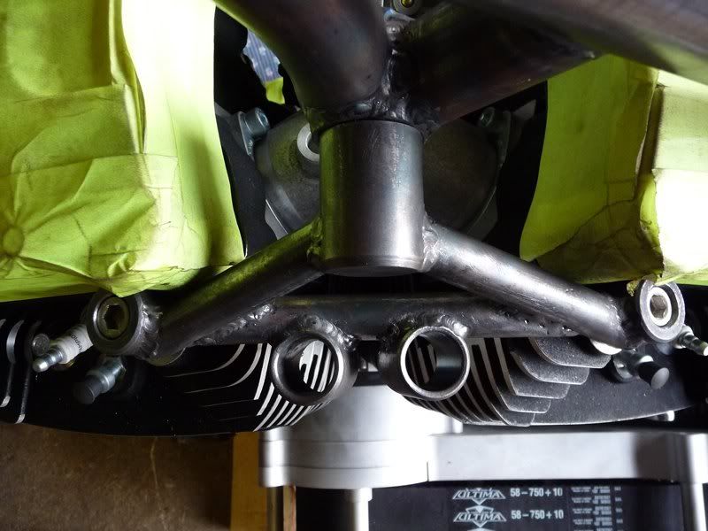

Finished fabricating the top mount - ready for paint when the time comes now.
