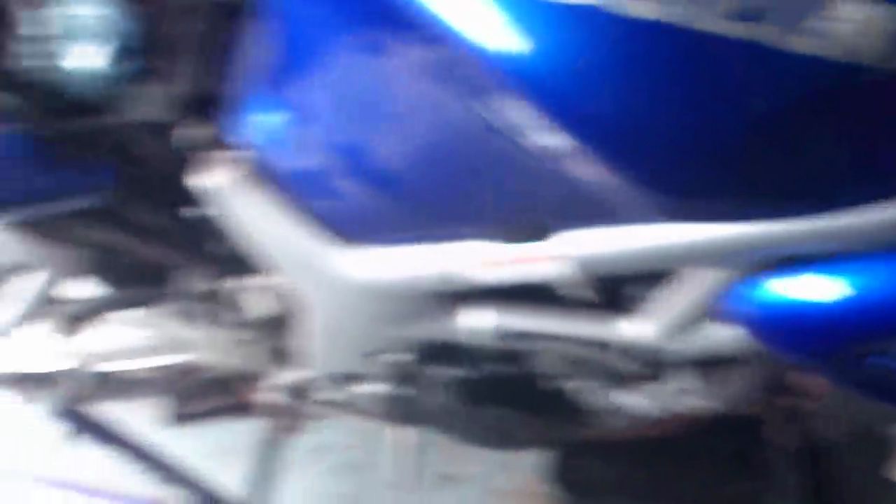

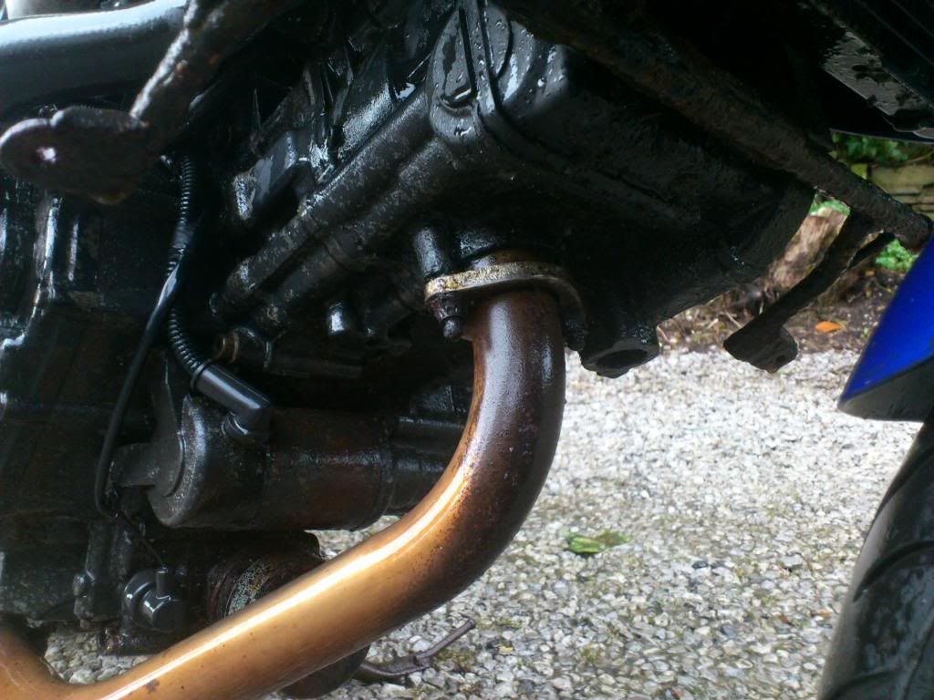

well, i started the project...here's how it looked before i had my hands on it
after a quick clean it became a little better
so once dried i got a battery on charge and waited a while... tried to get it started but it wasnt for having it, sooooo off came the airbox, cleaned a load of grime out of that, whipped the fuel pipe off and cleaned some gunk out and then had another crack at it...
i apologise now if pictures are too big...once i actually get to grips with photobucket i'll get them reduced down, i hate the thing and dont have a mass amount of time to sort it out lol.
but...it has begun....
