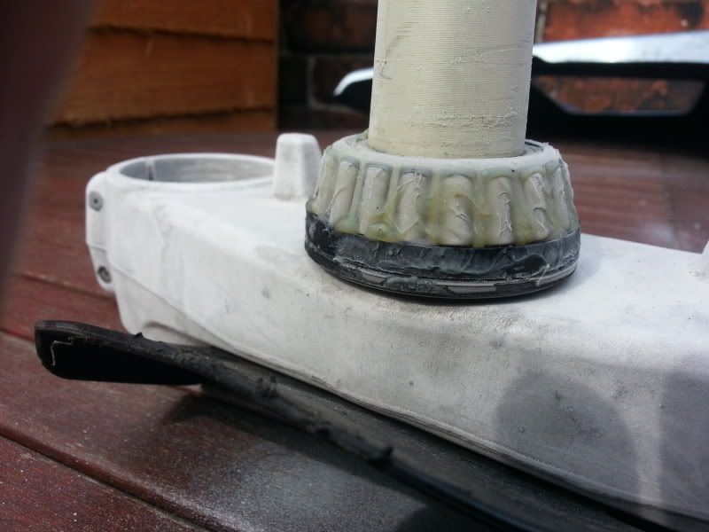

Ok so I'm changing the head bearings and so far have managed to get the old races out, the new ones back in and the old bottom bearing off the stem.
I've got the 32006JRRS bearing for the bottom and left the old dust cover on the stem. Was this the wrong thing to do and should the sealed bearing be fitted on its own without the sealing plate?

Forgot to mention, it's a GSXR750 K7 front end. Ignore the frosting, I'd had the yoke in the freezer overnight before fitting the bearing.

From that pic, the new lower bearing has an integrated dust seal so yes, wrong thing to do.
For future reference, not all tapered roller bearings are made with integral dust seals and in that case, it'd have been correct to use the old dust seal if still okay or fit a new dust seal.
You'd need to remove the bearing, take off the unneeded(in this case) separate dust seal and put the tapered roller bearing back on.
Unless you have a hydraulic press to push out the 'stem', I can't think of a way to remove the bearing without damaging it.
Good luck.

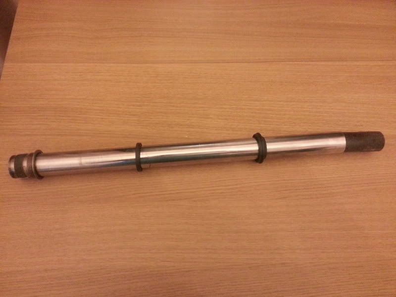

Luckily, I was able to cut the rubber off the old sealing plate then cut it with snips, a dremmel and bend it with pliers until it came off. With time and patience it worked without fouling the new seal/bearing.
Trouble is it was stuck solid and needed a few hours back in the freezer, an old fork leg, a stunt peg off a bmx and a lump hammer to encourage it to slide down the last 5mm.
Job jobbed!

It's always a good idea to use bearings with an integral seal. I have seen some that have been fitted with a seperate seal that fouls the bearing.
A good tip when fitting stem bearings, is to very lightly rub the stem down using 1200 grit wet & dry paper used wet, & to grease the stem, & the inside of the bearing with a little Moly grease. They slide on much easier than when dry. I press them on using my 6 ton Flypress, for which resistance is futile & I still grease the stem & bearing.

P.S. I like your improvised whacker. I have many old fork tubes that get cut up & used for other purposes.

Cheers for that. I think I saw you recommend the wet and dry tip in another thread when I searched before embarking on the job. So I'd done that as well as freezing and greasing the stem. It went on fine initially, it was only when I'd removed the old sealing plate that I couldn't move it anymore. Hence the whacker lol
