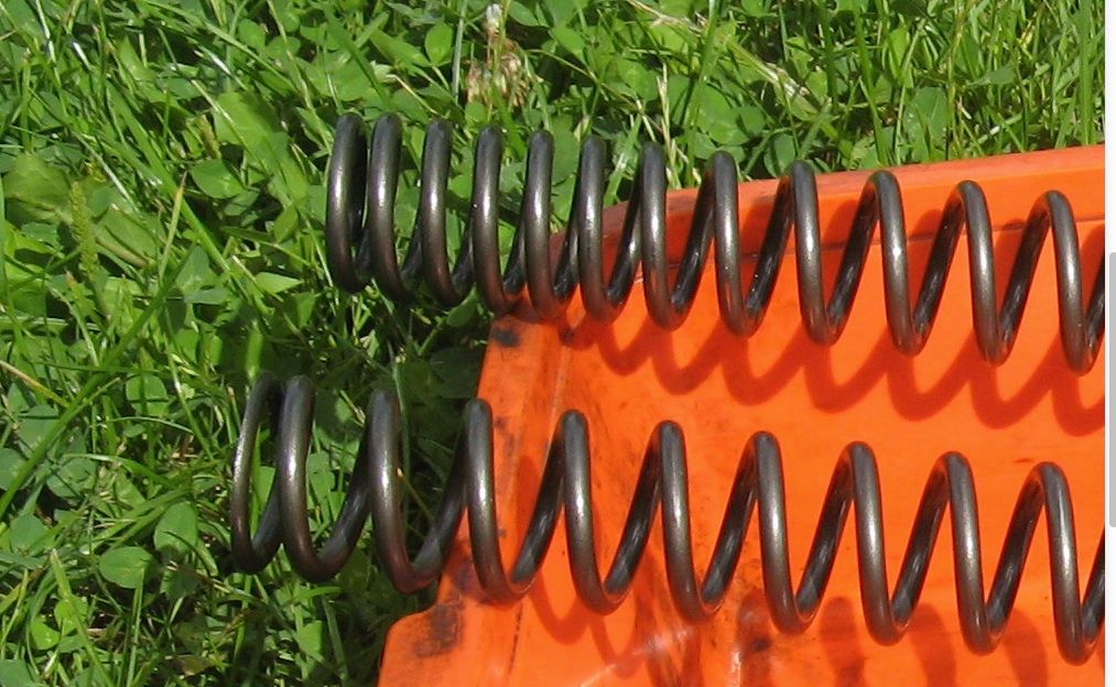

Originally Posted by dkid View Post
I could be wrong but I think the standard springs have a different rate at one end so may appear progressive. Are you certain yours are aftermarket?
Not certain, this is what the two different ends look like ..

dkid
Default Quick and dirty fork oil change
I have a feeling mine were the same when I removed them from my sv before the ktech linears went in. I don't have a pic but someone else may confirm these are stock springs?

Default Re: Quick and dirty fork oil change
could be stock, quite possibly. pointy ones are progressive
Cheers. Yes, faired Pointy. Looking at the manual more closely, I thought it was saying that the standard spring has a smaller diameter at one end, which mine doesn't. Now I see that doesn't apply to faired bikes which have a progressive wind instead.
I would have expected the tighter coils to be at the top. Is there any special reason Suzuki put them the other way round?
