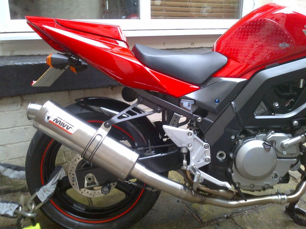

Had a look at a Mivv exhaust, they provide the link pipes so that you don't have to make any cuts to the OE exhaust system, anyone used them?
Fitted my Mivv oval a few months ago.
I was a bit sceptical about the quality of the system as it costs the same as many end cans but the quality is excellent.
It was easy to fit and obviously no cutting, hardest part was removing the original exhaust bolts.

I came across them via
http://www.motorcycle-exhausts.co.uk...uct--2660.html
How does it sound?

I'll second the quality of the Mivv pipes, not an SV, but they actually make the OEM on the Aprilia, the race pipes are road legal (with the baffles fitted) and the finish has help up very well for the last year of use .
Cheers Mark.
