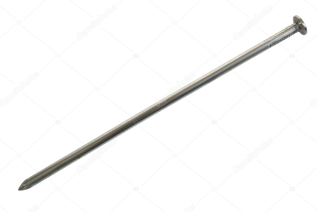

I did ride home with the screw in and it was very large nail and not a screw , almost as large if not bigger than the pic below.
after that I pulled it out and repaired it using the puncture repair kit so could use it for 1/2 days until I got my new tyre "Dunlop roadsmart II".
The reason for change was, I had the tyre repaired 3 time ( all from inside professionally done) and two of the repairs were very close to each other so the patch inside did overlap the other one .
this last puncture (4th) was again very close to the other 2 making it 3 puncture in one area which in my view is very unsafe so just left it all together.
It is a lesson learned to have all I need with me to quickly repair it and carry on until I can get it probessionally done .
Do you think normal puncture repair (from outside) would be ok for city driving of up to 50-70 miles?
http://static3.depositphotos.com/100...75102-Nail.jpg
