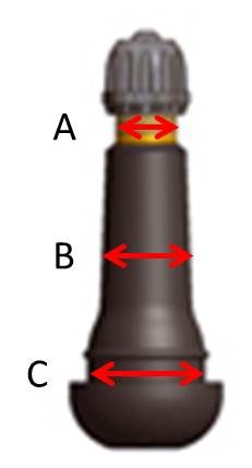

Gid and mrs came over on Saturday so we had a go then, we got the rear tubeless tyre swapped fine, no big bang as it seated but it’s deffo on there and had it up to 60psi before letting some air out, but then when we got the front TUBED tyre off, I had a problem with the ‘bung’ type spare valve I had. The hole in the wheel to pass the valve through was pretty much the same diameter as the threaded valve shaft itself (A in the diagram below) so couldn’t even pull through the rubber coated part of the stem (B in diagram) let alone get the bung part (C in diagram) in place
So I’m a bit lost, does this mean that the wheel will only take a tubed tyre?

Both the WM and CP profiles were meant to be used with tubes and should be used with tubes.
.No one is going to say it is OK to run tubeless where there once was a tube — it’s just too great a liability exposure. As an added impediment to going tubeless on tube-type rims, the valve stem hole in the rim is larger on tubeless rims than on tube-type rims. To use a proper tubeless valve stem you have to enlarge the hole in the rim. Once you do that, I’d think you’d never be able to go back to a tube in that rim. I

I'd try chris' idea before you spend anymore money, it might inflate a bit of a funny shape but that remains to been seen. As I said the other day the only option I can think of is taking a wheel off another bike and retro fitting it or swap out the front end. It could all be done on the cheap.
I would imagine fitting a tubeless tyre in place of a tubed would just lead to it losing pressure gradually or quickly.

The letters reference to the shape of the bead seat.
Tubles types have a ridge to locate the bead and then a space were the bead seat fits in.
Some wheels this is either no ridge or too small a gap twix ridge and the edge of the rim.
The side wall can then be pushed off the rim,pop no pressure. Nasty mess.
You can probly see if you have the right shape by eye. but I don't think that the Chinese are in the habit of following international standards so check the complete circumference.
A bit of thick card as a Guage that fits a tubeless wheel be easily made up.
It is your call if you belive it will stay seated

Nothing wrong with putting a tube on the front, just because the tyre is rated as Tubeless doesn't mean it's unsafe with a tube.
