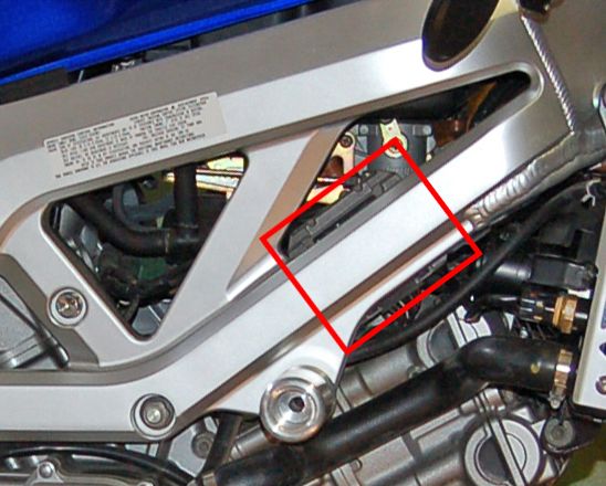

Am I right in thinking its behind the rear fairing and easy to do? (2004 model here)

Default Re: SOMEBODY must be able to diagnose this.. (SV's about to be thrown into a lake)
fairly easy. it requires you to take the airbox out and coil off for easy access as the connector is a PITA to get at otherwise. sitting on the bike its on the right hand side bolted to the frame. you need to inspect the connectors coming off the reg/rec and you might as well inspect the ones behind the left hand rear plastics as well.
its easier to take things off to gain full access rather then guddle about especially if you need to clean or replace the connector.

Ok cheers mate. So am I right in thinking its around the same location as the green connector? (Typical I've put all of the front of the bike together )
no its under the airbox roughly at the coil
