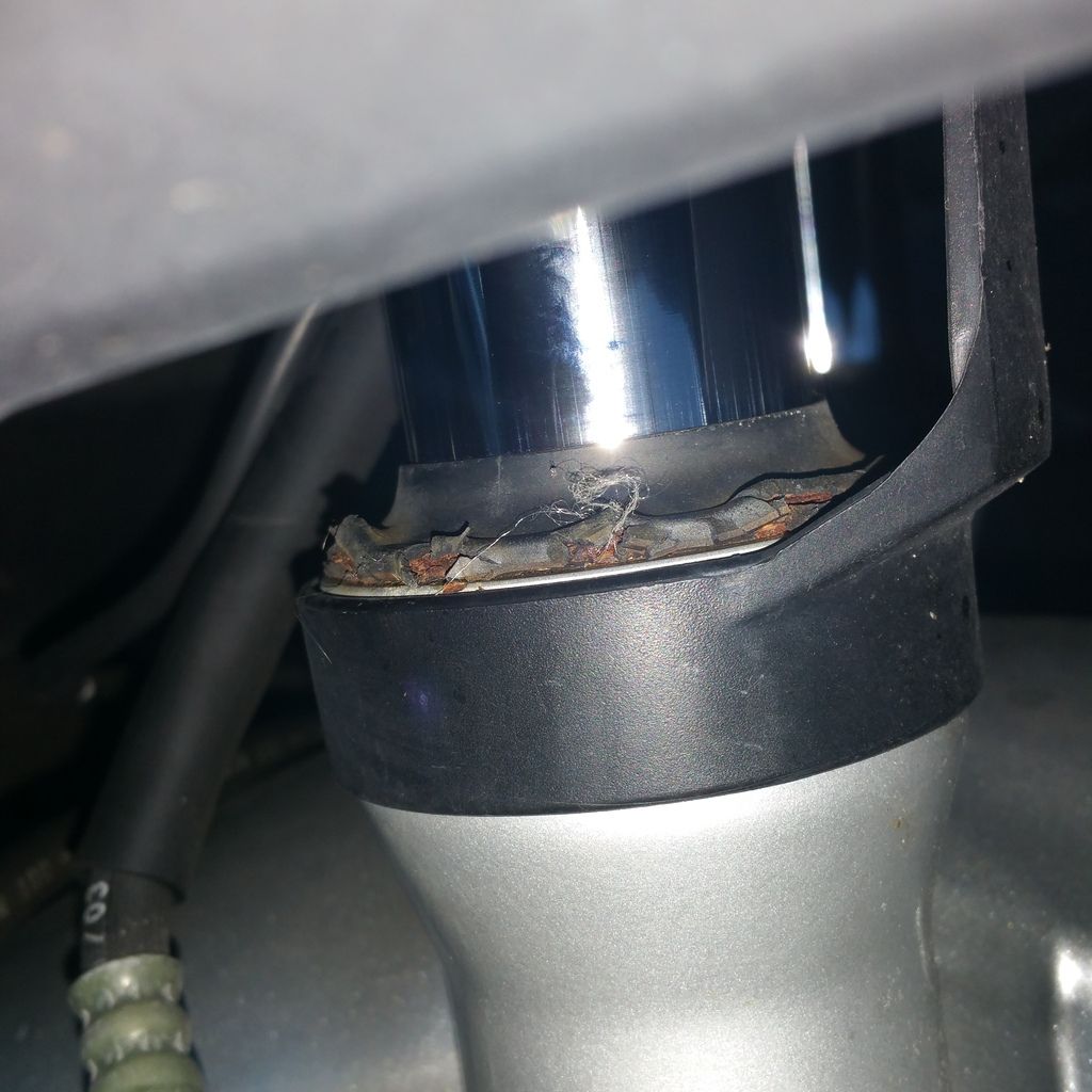

Default Front fork seals. Is this normal?
So I just checked my front fork seals as it's going in for a fork service Tuesday and was confronted with this?!?!? How can this have passed it's MOT? It's my fault for not looking when buying the bike but wow.
Old 27-09-15, 06:23 PM   #2
Default Re: Front fork seals. Is this normal?
That's just the dust seal, not the oil seal.
Get it replaced when your forks serviced

Old 01-10-15, 08:54 AM   #4
tojo82
Just got my bike back from the fork service. Turns out some did it them self a few years ago but only did one side of the forks so I had a few years old oil one side and 11 year old deteriorated old the other at different levels also. That would explain the issues I've been having.
Old 02-10-15, 07:38 AM   #5
Ah yes, not good for the handling
