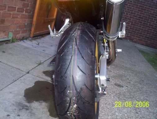

The tyres you've found are not the standard size fitment for your bike. I think though that you should be OK with the 70 profile front tyre, but it will alter the way your bike tips into corners, I think it'll make it tip in and turn faster to. Also it may make your speedo a little more accurate to. But you might end up with clearance issues with your front mudguard. The rear tyre you've found wont fit a standard size SV rim. Its to wide. You want a 160 width tyre not a 180. If you put the 180 tyre on a standard SV rear rim, I believe it pinches / stretches the tyre and it wont sit on the rim properly not something I'd want on my bike. It will also slow the steering down.
Personally if it were me I would and have stuck to standard size tyres. Your bikes designed with those in mind.

As fizz said the front will be ok the are a few members running a 70 profile frot tyre. The rear will not fit on the standard rim and will be dangerous! You will need a 5.5in rim to fit the 180 section tyre and some spacers and slight modifing to fit the wider rim! But it can be done!!
It's a 1200 Bandit rear wheel fitted into a 1999 curvey.
