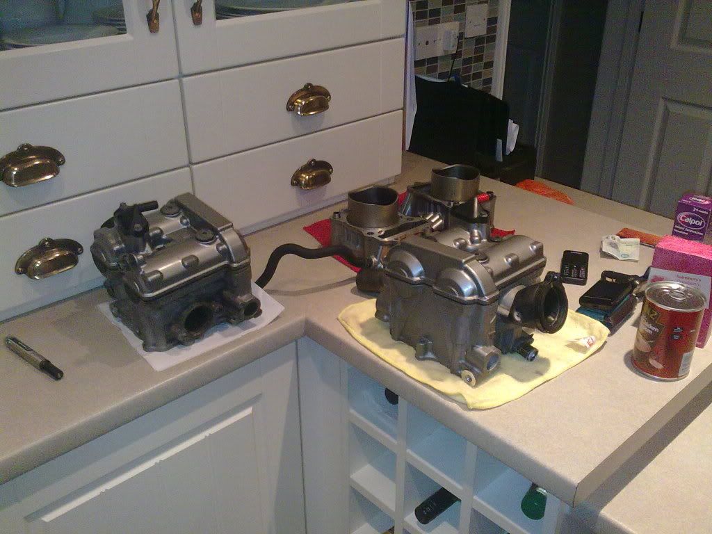

well go a bit more done today
bike started out as a fully running and rolling minus the exhaust
i proceeded to strip it down

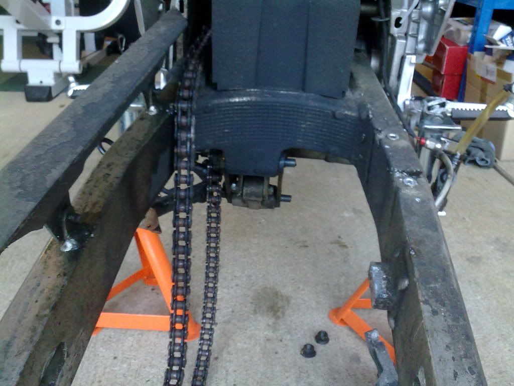

im dropping the swing arm off as well, but dont have a 19mm hex socket :/
its all a bit sh*tty
so far i have the air box off the TBs un hooked and the rear cylinder head off, rad off and other bits, will take the rear cylinder off tomorrow and then move on to the front, going to try and get the cylinders hone'd this week some time

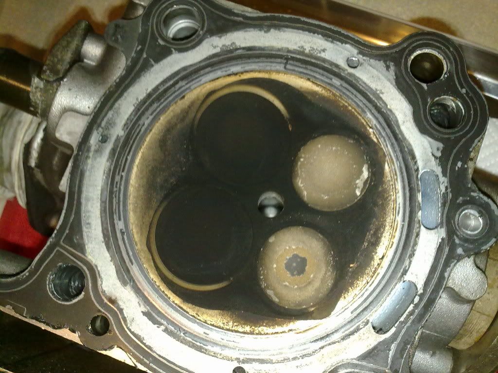

valves dont look to good

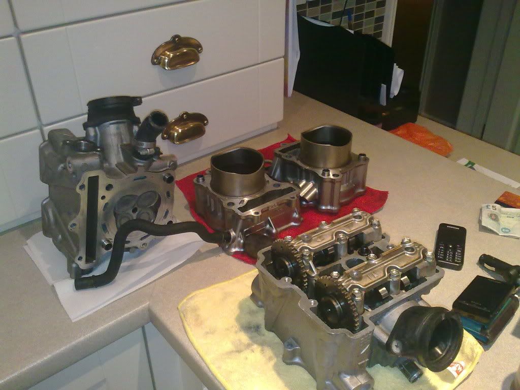

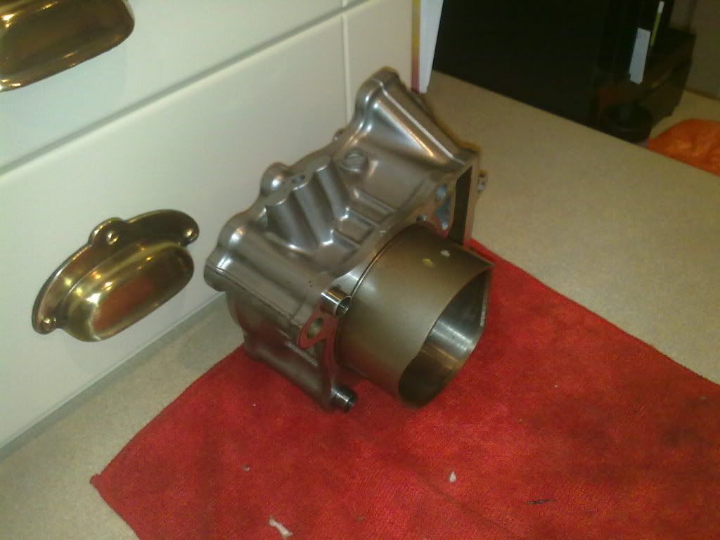

barwel1992

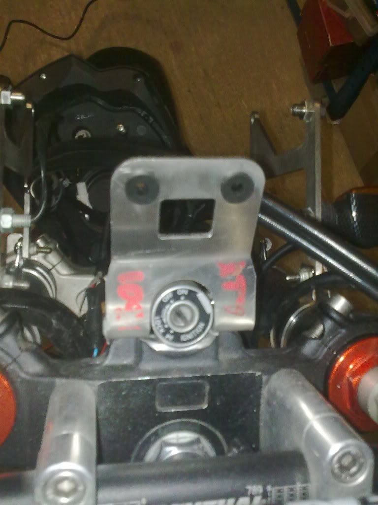

Default Re: busa piston swap - work in progress
so all the heads and barrells off yesterday cleaned chambers sorted the bike for the new pistons, just need to make a phone call and get barrel's honed and stick it all back together

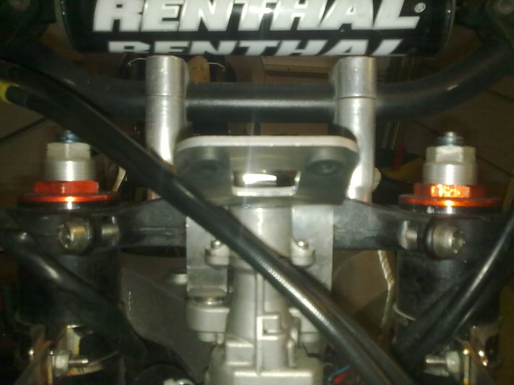

also go a new clock bracket made that i designed
just sanded and primed it going to paint it black

Ed
Impressive, that looks really clean. But in the kitchen...

barwel1992
lmao thanks thats exactly what the gf said
Old 12-01-11, 10:29 AM   #26
Has your mother not tried to kill you with a conrod yet?
Old 12-01-11, 10:41 AM   #27
Stig
That's what kitchens are for are they not? Food comes from takeaways.

Old 12-01-11, 12:24 PM   #29
ThEGr33k
Man looking at those heads, I didnt realise how badly designed the intake route is, its a right bend the air/fuel has to go through from carb/injector to the cylinder.
