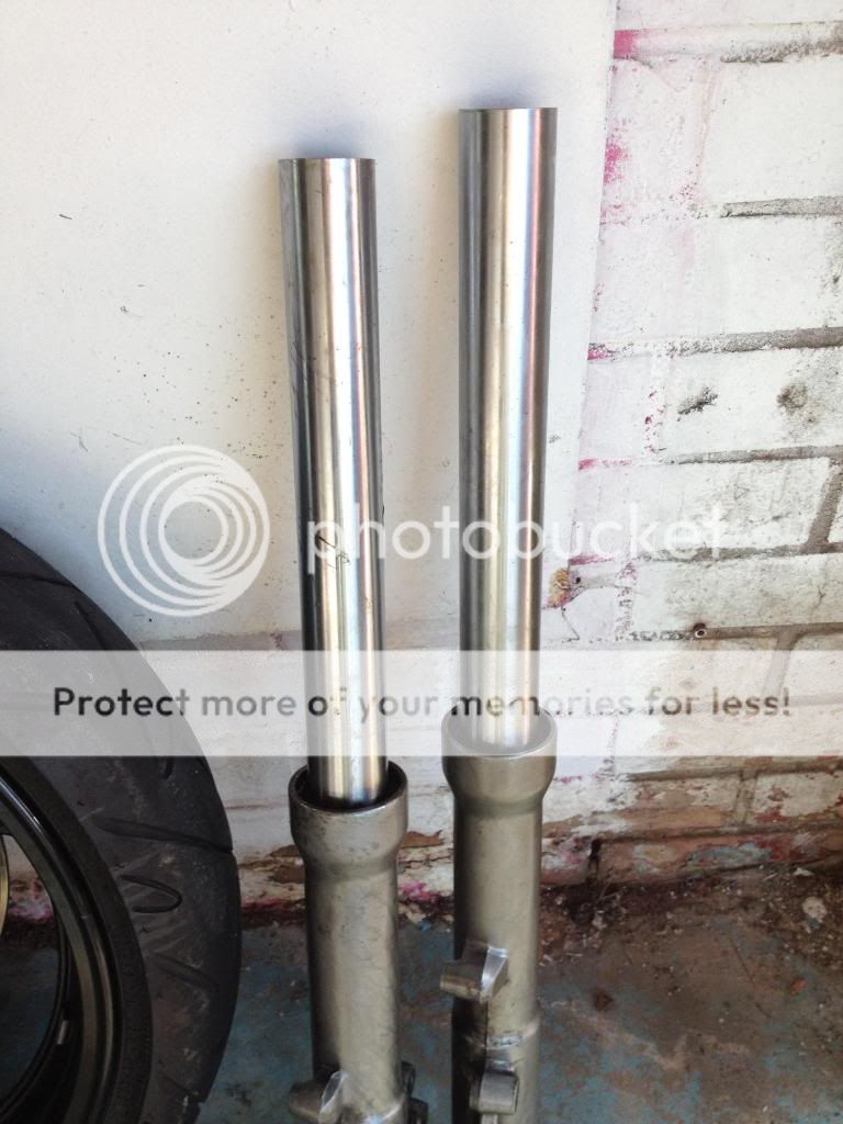

So got the SV forks apart, easiest job in the world! Could not believe how quickly they came apart.
I reckon i'll be painting the fork legs as they do look a bit flaky!
My one notable point is the size of the Damper bolt (ie the bolt at the bottom of the fork leg) It's a 6mm hex, and the ZX6R is a 10mm hex..... I have a feeling I will be drilling out the SV fork leg to accommodate the ZX6R Damper rod bolt.

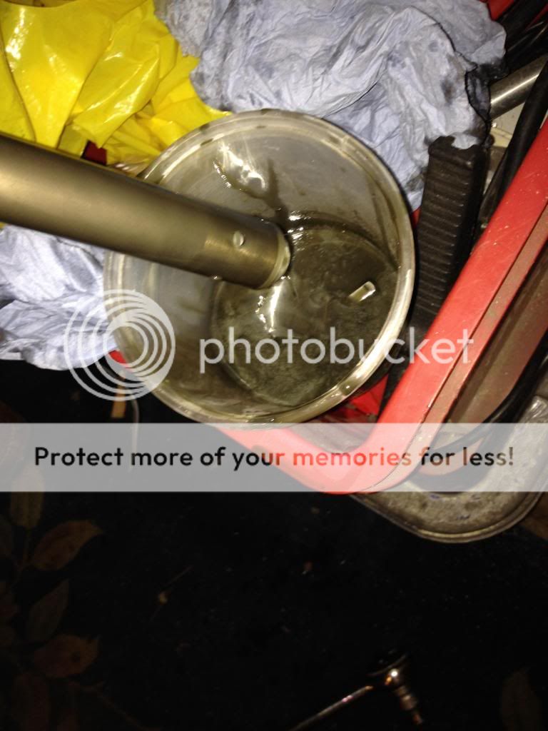

I knew my dad would have the answer to get the cartridge out, so a trip down the road to the old mans workshop was required ( No "tribal wall paintings" in his man cave )
Turns out the perfect solution was the end of a pinch clamp! Fitted perfectly into the square hole and held it in place while I undid the damping rod bolt.

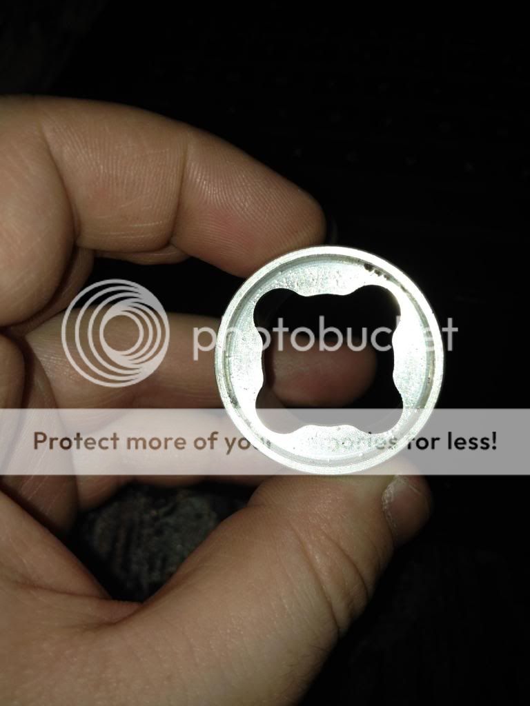

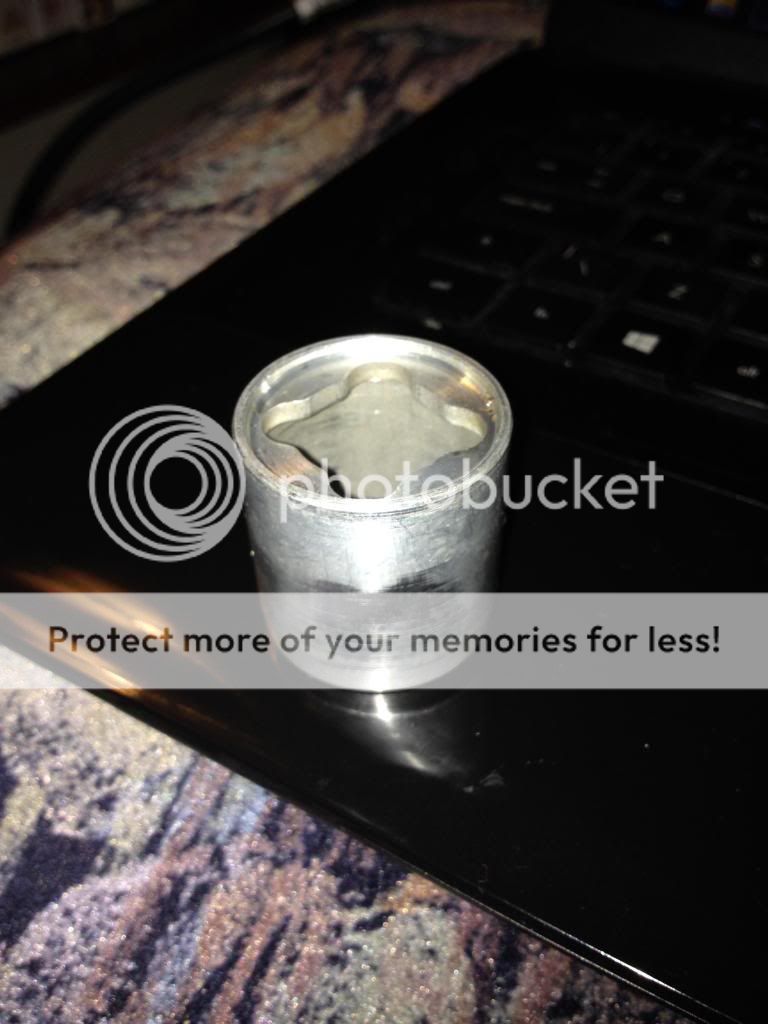

Now, as we were cleaning up, this random bit appeared, but we could only find one? It fitted perfectly into the bottom end of the fork tube, but it didn't appear to be there before (look at the pic down the fork). I've checked through the OEM part diagrams online and can't see anything like it?
My dad / brother does have a mustang project on the go,but it just seemed to be too good a fit to be a part of a 60's muscle car!
Any ideas where on earth it came from and what it does? Should there only be one or have I lost the other somewhere?

Old 24-02-14, 11:52 PM   #19
Sid Squid
No, I don't lend tools.
Sid Squid's Avatar
Posts: 8,680
Default Re: SV650 ZX6R F1 Fork Hybrid
It's the oil lock piece - they're on the fiche and in the manual.
There should be one in each leg.
Old 25-02-14, 08:29 AM   #20
They get stuck in oil in bottom of leg sometimes
