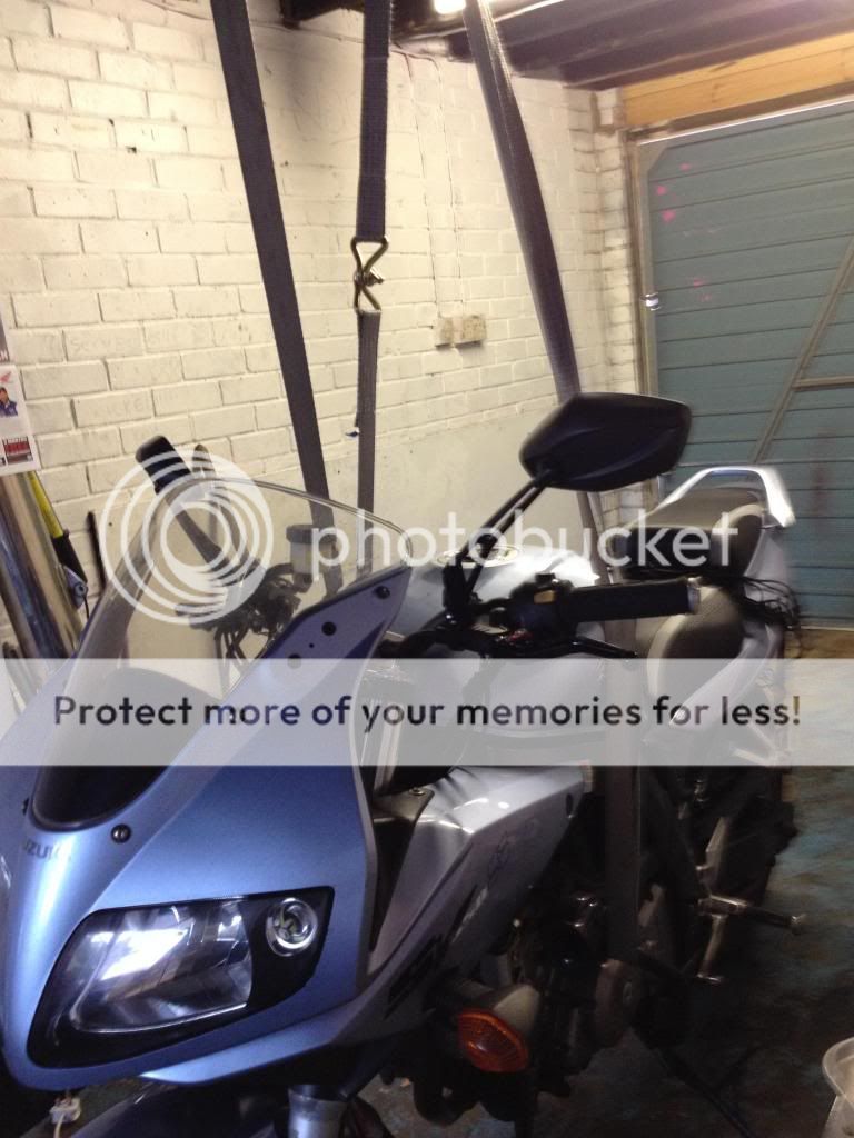

Hoisted up the bike using some ratchet straps and started to get the forks out.
Made sure the brakes where tied up (using the very latest technology in torn plastic bags)

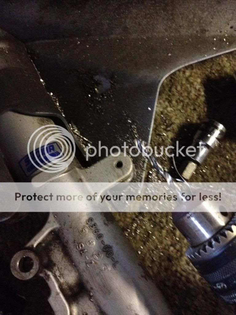

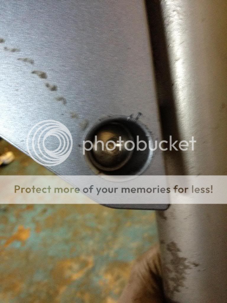

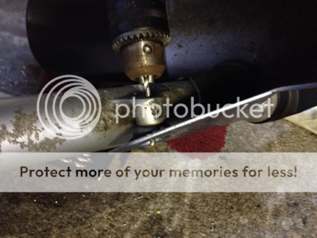

Now here's the first hiccup. Bloody alan bolt holding the front fender stripped (made of brie)
So decided to drill it out from the other side, easy peasy!

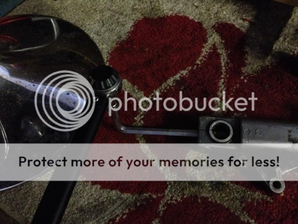

After all this some clever sod forgot to loosen the top caps, remember to do this before you start! Only half a turn or you'll cause problems when you lower them off the yolks. I just put them into the lower clamps and did it, made it easier anyway as the wires/cables were in the way at the top yolk.

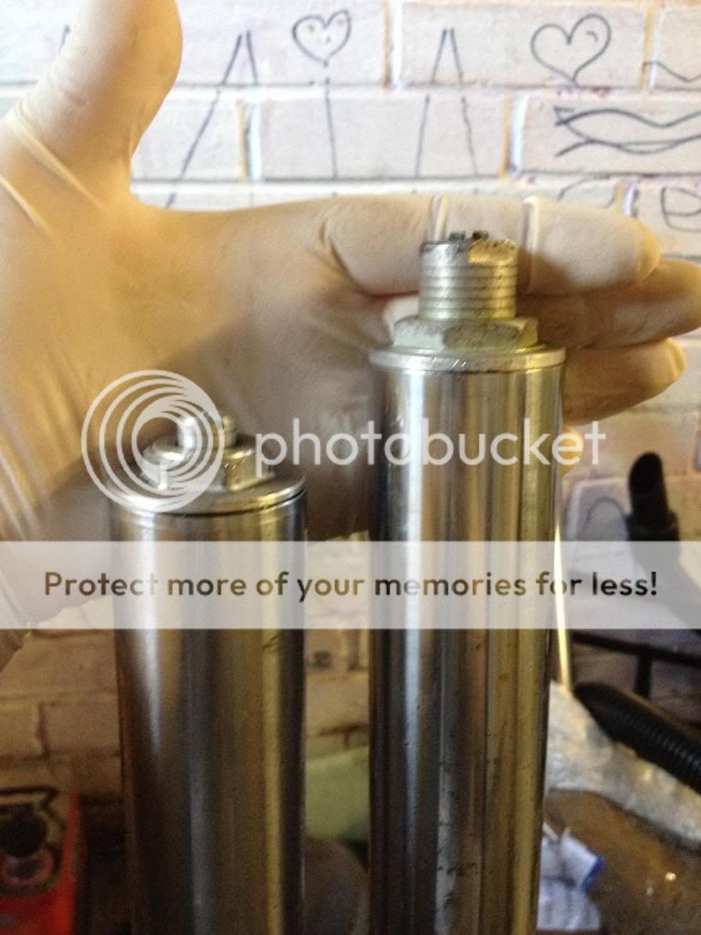

Ok so just to visualize for later, the ZX6R forks are slightly taller than the SV forks, only by 25-30mm, so if you want to keep a similar geometry, raise the forks by 25-30mm through the top yolk when they go back in.
(SV left, ZX6R right)
