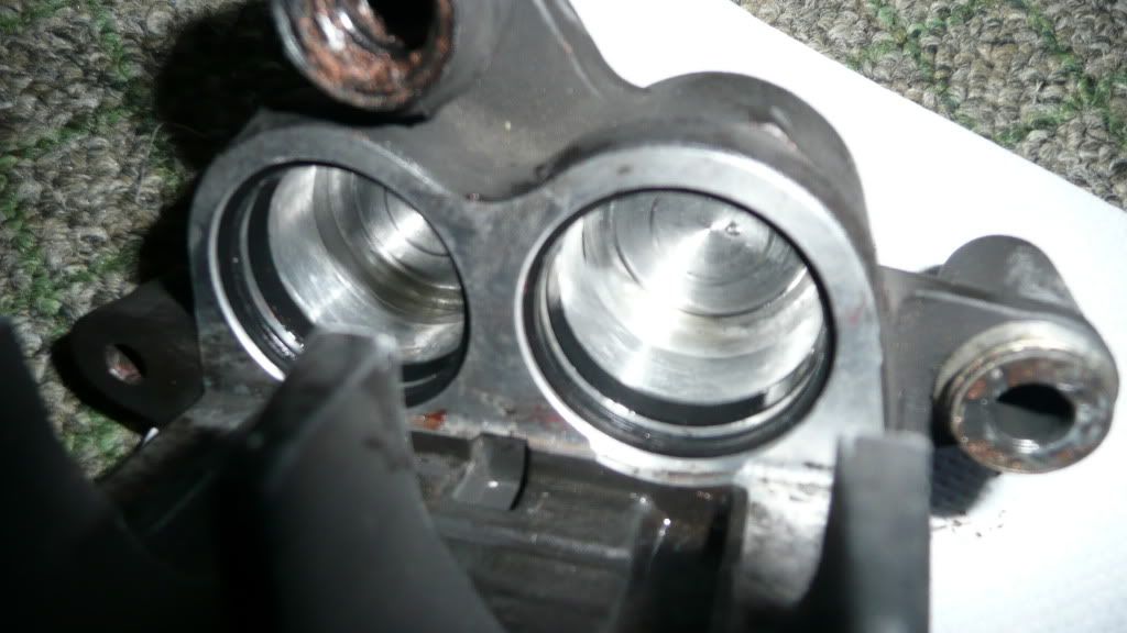

I took my front calipers off today, for a complete overhaul, reaady for spring.
The right hand side came apart like a doddle - pin, pistons, everything just came apart like clockwork
The left hand side however...pistons are stuck. I've mangled them now anyway by being too hamfisted, there are pit marks all on the inside of the pistons. But try as I might my puny arms cannot muster enough strenth to get them out
I'd say they are about half way. They turn fine, just wont come out any further.
Needless to say, no access to an air compressor or anything like that.
Any tips? Dont care if its destructive to the pistons, I'll be getting new ones anyway.

ohh and if the inside of the piston is scratched that doesn't matter its the out side that slides over the seals that matters, and when removing the pistons put a bit of 3in1 in the grove where the seal is and rotate them out dont just pull them straight out as its harder to do like that
HTH
PS clean the seals in warm soapy water then inspect, dont use brake cleaner it will dry them out, if you have a dish washer strip the calliper's down so there is no seals or any thing just the body and bung them in the washer with no tablet (or dishes) and wash away lol
should look nice a clean like these with no gunk in the bottoms of the bore

The outside of the pistons have a few marks as well I'd probably reuse them if it werent such a vital safety part
I'll try some 3-in-1 overnight and try again tomorrow.
