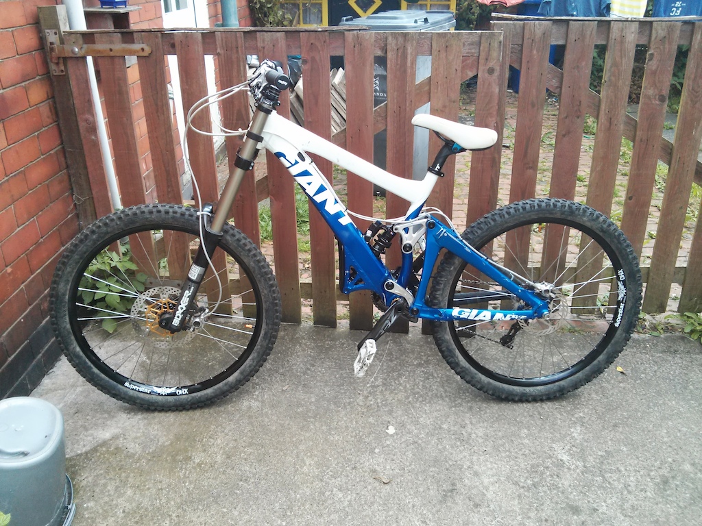

Well built a new DH bike up. Rides like a beauty, managed to **** up mind on first run out. Here is the bike and below that the video of me cocking up, then one of me not... Managed to twist my knee so off of MTB for a few weeks :'(

BRRAAAAAAPPPPP. That is lovely. I particularily like the way you fell off on a really simple bit at Antur instead of a really deadly bit
