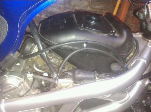

Fitted & carbs balanced. Look Bibio I even fitted the well nut!

Thank you Bibio, if I never have to get at that front vaccum nipple again it'll be too soon. Out of interest what was the thinking behind the T for the oiler? Was it for if you didn't already have one fitted? I didn't have to use it in the end.
yup. i seen you had already fitted the one in the scottoiler kit with that photo.
my brain must be on a rest year
kit was designed to insert as close as possible to the vacuum spigots and looking back on it i'll admit i was too busy thinking of the tails to realise that people would already have a T piece branched in.
do you want me to send out a new line or blanking plug?
Old 08-06-12, 12:47 PM   #69
HoL
Default Re: Group Buy - Carb/TB permanent extension Tails for balancers
Not at all, it works perfectly & I'm rather happy - only cut my hand once squeezing past the radiator . I'd be interested to see if you can figure out an extention to the carb sync adjustment screw (kinda like the idle adjustment one) so then the airbox wouldn't have to come off
