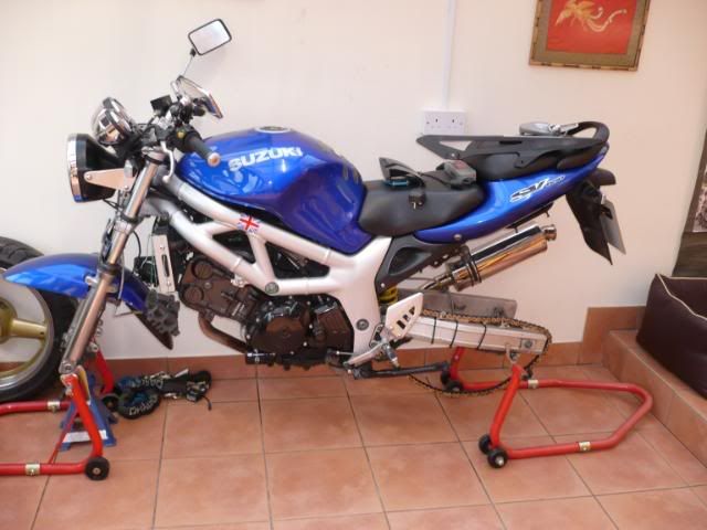

First job was obviously get it on paddock stands and remove the wheels!
Just make a note of the nice clean floor(for now anyway, haha!!!)

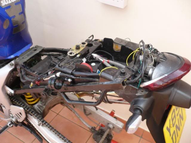

Then to start removing the other bits and bobs!!
Undertray and rear wiring removed
By this point I've started to see the dirt and general crap that lies hidden underneath and am realising how much cleaning is actually going to be involved(remind me, why am I doing this??)

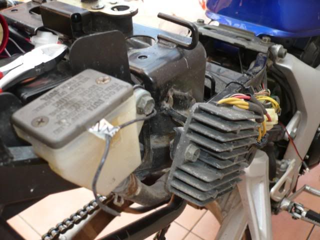

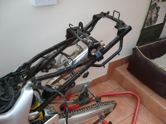

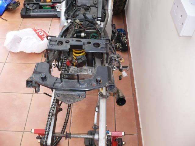

Anyway carrying on!
I then removed all the rest of the bits that were lets face it, getting in my way and then removed the rear subframe which I plan to repaint or powdercoat as it looks like it has seen better days!
Oh and notice how at this point the floor is still quite clean!!!How long you reckon that'll last???
DISCLAIMER!!!!
Next stage, I cannot be held responsible for your stupidity(you know who you are) if you remove the rear suspension without supporting the middle of the bike!
This would definitely not be advisable, come on I might have had broken the tiles then I would have been in the s**tter!!!!

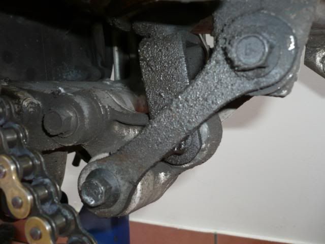

This, OMG, it's dirtier than a russian lady of the night(you know what I mean), here's a slight clue!!!!
get what I mean????
And this is even dirtier, if that's actually possible?

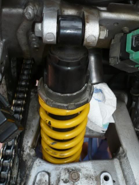

Next one, just a different angle with the shocker removed, oh and notice the nice shiny toolkit on the floor, courtesy of halfords for just 39.99, down from 89.99 in the sales!!!
I wondered why the rear cylinder didn't seem to be firing correctly, maybe it's something to do with the kitchen roll in the rear manifold,lol!!!!How did I miss that?
And here!

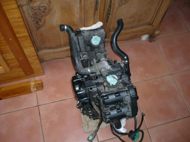

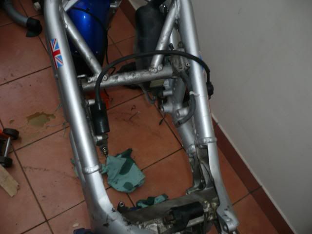

I may have forgotten the camera was here at this point, because the engine has come out and headlights and clocks have been removed!!
however had the assistance of my pregnant wife to remove the engine!! She is a star you know!
Oh yeah and floor is really dirty now, splatterd with coolant, oil, grease and yes lots of sweat!!!!
Surprised actually how light the engine is, even the wife can lift it!!!!
Last engine we removed took 3 of us and was a damn site heavier(ok it was a gpx1100 engine made of cast iron, granite, lead, I don't know it was just fecking heavy)
Now for one handsome piece of mechanics!!!
I've even sat it on one of the wifes nice fur cushions off the bench!!!
Right, I may need your help with this one!
I keep staring at the photo and can't seem to work out what's missing.
What do you recon??
Bit of a jump again I'm afraid!
Was getting late and wife was moaning about having to clean up at stupid time at night so thought I'd better get a shift on, plus losing valuable cod4 playing time!!!

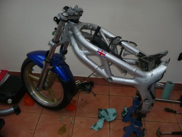

Removed rest of wiring and other few pieces and this is what we're left with, about 4 plastic tubs later!
So there you have it, one bike completely dismantled.
And apparently that's the easy bit!!!(My *ss)
