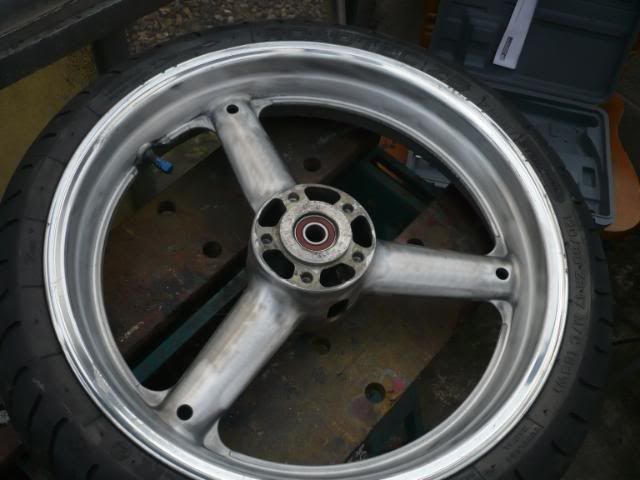

yeah not bad used paint stripper and then used the cutting compound to remove so its working very well but waiting for more compound to come through the post!! so will post when completed hopefully!

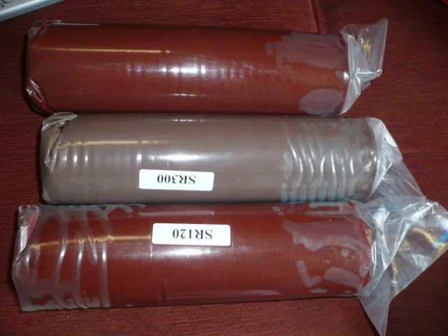

what cutting compund you using??? fareckla??

not sure what it is just 80, 120 and 300 grit from www.thepolishingshop.co.uk which if you look its called abrasive compound tube in 1.35kg bars. not sure of the make but its really good stuff.
Old 10-10-09, 08:52 AM   #257
liamsimpson
Default Re: sv650 stripped and being cleaned/polished
well this arrived in the post this morning!!
So may the polishing commence!!! Should have the front wheel done today i hope.

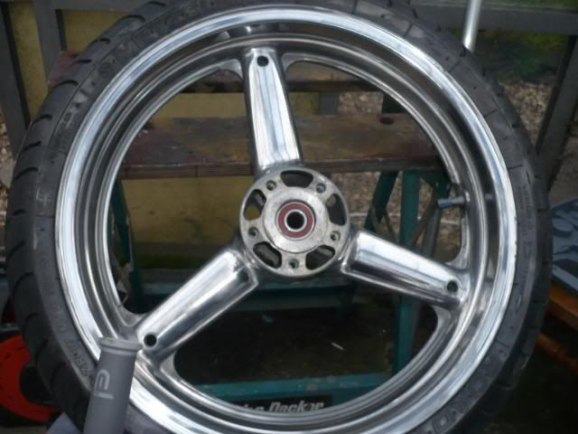

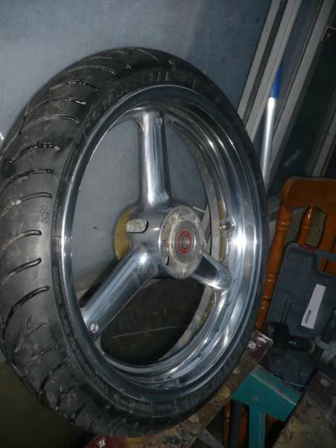

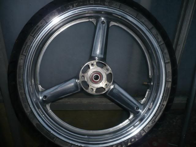

so 6 hours later and i have done one side of the front wheel!!!!!
First more 80 grit,
then 120 and 300
then lots and lots and lots of polishing!!!!!
What do you all think?????
